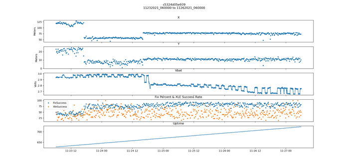

I'm experiencing a strange issue that I can't seem to figure out.  We've built a location system based around the nrf52833, and we're currently running this system in a pilot installation at a customer site.  Tags (consisting of a nrf52833, a LIS3DH accelerometer--which is disabled, and a CR2477 battery) are mounted on short flags with strong magnetic bases--the tags are mounted about 8" or so from the magnets.  The flags are stuck to/pulled from heavy equipment moving around a very large shop floor.  In addition to location, the tags periodically uplink their battery voltage.  What we've found is that every once in a while, a tag will enter an anomalous state in which it suddenly begins to draw a constant high current (as evidenced by the battery voltage), and dies within 10 days or so.  I'd estimate the current to be around 3mA, which is consistent with the processor not entering its low power idle state.  However--and here's the part that's confounding me--we can remotely reset these tags, and doing so does NOT cause the behavior to go away. The only way to 'fix' the issue is to physically remove the battery and put it back in.  I've pored over our code, and there is nothing I can see that would persist across a SW reset--yet would be cleared via a power cycle--that could prevent the processor from sleeping.

I've attached an image of the malfunction occurring.  About a third of the way across, you can see the Vbat suddenly drops and then begins a steady ramp down.  The start roughly coincides with the tag moving (note the change in X/Y).  I believe in this instance the equipment the tag was on moved to a new workstation, then shortly after the flag was pulled off and moved nearby (workers have to do that occasionally) and that's when it started.

    This is pretty strange - the device is operating normally, does not use the I2C, and also does not recover through a soft reset. Maybe it could be the position of the battery even though it seems unlikely.
    As you indicated, peripherals and interrupt states will generally not persist across soft resets. One exception is the debug interface (see Debug Interface mode), but I think you have to be quite unlucky to get it enabled by some random clock pulses ( assuming the bottom side of the coincell can come into contact with the pads - the SWD lines have internal pull-ups).
    Do you use System OFF mode in your application? I'm asking because it's not possible to enter this mode while the debug interface is enabled.
