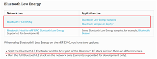

2. Below was from SDK Connect documentation. There are two options for BLE. RPMsg or RPC at network
core. I chose RPMsg since all bluetooth examples can work at application core. Then, at peripheral_uart
example, I used set_tx_power and get_tx_power API from hci_pwr_ctrl to change 5340 tx power. But, it
failed.

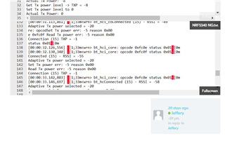

Hi
The error log was already posted at previous mail.
Could you check it with your internal team.
As NRF5340, if bluetooth sample at application core and RPMsg at network core, could it support changing tx power at application core?
Thanks.
