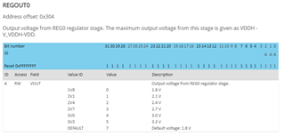

⦿ Ways in which we have tried to change REGOUT0 to 5:
1_))
Guide says: “The firmware must set REGOUT0 to 3 V in order to allow it to be debugged from a DK. This is handled by the BSP if it is used with board correctly set to pca10059 by defining BOARD_PCA10059, and the firmware calls bsp_board_init().”
a. We opened ../nRF5_SDK_17.1.0_ddde560/examples/peripheral/blinky/pca10059/mbr/ses/blinky_pca10059_mbr.emProject in Segger Embedded Studio.
b(1). Edited Board Definition > boards.c line 114
     from (UICR_REGOUT0_VOUT_3V0 << UICR_REGOUT0_VOUT_Pos);
     to (UICR_REGOUT0_VOUT_3V3 << UICR_REGOUT0_VOUT_Pos);
b(2). We also tried editing line 108 if ((NRF_UICR->REGOUT0 & UICR_REGOUT0_VOUT_Msk) ==
    from (UICR_REGOUT0_VOUT_DEFAULT << UICR_REGOUT0_VOUT_Pos))
    to (UICR_REGOUT0_VOUT_3V0 << UICR_REGOUT0_VOUT_Pos))

If the code NRF_NVMC->CONFIG NRF_UICR->REGOUT0 etc in the 'if' statement is hit. The nRF52840 dongle does not do anything.  Subsequently, writing some firmware to read the value of REGOUT0 and getting an LED to blink that number confirms REGOUT0 is still set to 4 and VDDOUT is still at 3V

REGOUT0 = 4 for 3V0
REGOUT0 = 5 for 3V3
REGOUT0 = 7 for Default

    1. To change REGOUT0 for 3.3V using SES and nRF SDK. Do we need to connect the nRF52840 Dongle via nRF52840 DK Debug Out in order to change the UICR?
    You can write to the UICR from firmware even though you cannot erase it, so as this involves flipping more bits from 1 to 0 it is possible. But you cannot revert back without a debugger.
    2. Can Zephyr make changes to the UICR?
    You can flip bits from 1 to 0 regardless of using any RTOS or bare metal as long as that is not explicitly prevented. For (instance you cannot do it while a SoftDevice is active). Therefore it makes sense to do any changes in the UICR early. You can see how REGOUT0 is set for the dongle in zephyr/boards/arm/nrf52840dongle_nrf52840/board.c and this is where you would want to make changes.
    3. Using nRF Connect and Zephyr. Where might there be code resetting REGOUT0 to 4 (3V)?
    To flip bits from 0 to 1 you need to do a page erase of the UICR, and that must be done from a debugger.

    Emerson Warwick said:
    Might nRF52840 Dongles be shipping to customers with REGOUT0 already set to 3V0 already?
    Yes, that is the case.
    Therefore, new dongles no longer having to run the code to change REGOUT0 from Default to 3V0?
    Yes, that is true. However, the code is present in the bootloader that ships with the dongle, though it only does work once as it checks the existing UICR content from <nRF5 SDK>\components\boards\boards.c:
    #if defined(BOARD_PCA10059)
     * Function for configuring UICR_REGOUT0 register
     * to set GPIO output voltage to 3.0V.
    static void gpio_output_voltage_setup(void)
        // Configure UICR_REGOUT0 register only if it is set to default value.
            NRF_NVMC->CONFIG = NVMC_CONFIG_WEN_Wen;
            while (NRF_NVMC->READY == NVMC_READY_READY_Busy){}
            NRF_UICR->REGOUT0 = (NRF_UICR->REGOUT0 & ~((uint32_t)UICR_REGOUT0_VOUT_Msk)) |
            NRF_NVMC->CONFIG = NVMC_CONFIG_WEN_Ren;
            // System reset is needed to update UICR registers.
            NVIC_SystemReset();
    The above is more or less equivalent with the code you find in <nRF Connect SDK>\zephyr\boards\arm\nrf52840dongle_nrf52840\board.c.
    Steps to reproduce
    This approach looks good. However, I see now that this will not work though, and can never work with this approach, so my previous answer was incorrect. Specifically I remembered the values of REGOUT0 wrongly. From the documentation:
    When the dongle is shipped, REGOUT0 will be 0x4 which is "100", and to change this to 3V3 you need to make it 0x5 which is "101". This involves changing a '0' to a '1' and that can only be done with a page erase, not a writing. So unfortunately this can only be done using a debugger.
