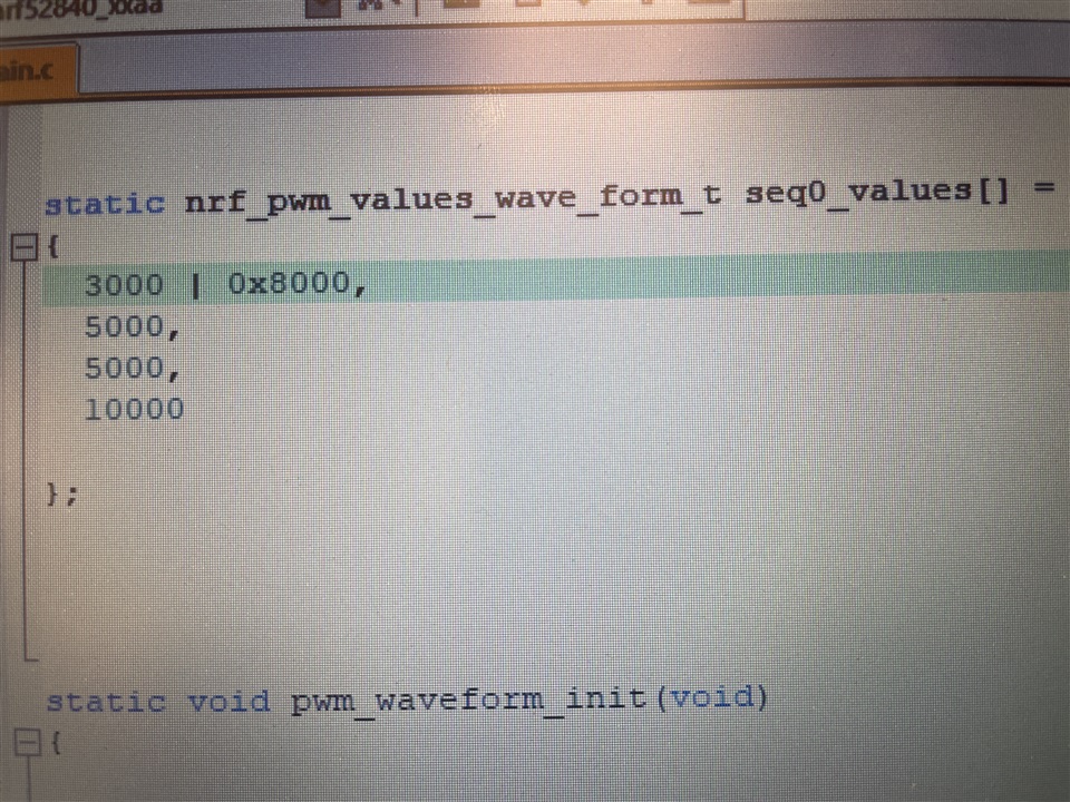

However, the problem is that no matter if I use | 0x8000 or the NRF_DRV_PWM_PIN_INVERTED flag, the polarity of my pin does not change and I cannot see any polarity change in the oscilloscope. I am using an nrf52840 dongle.

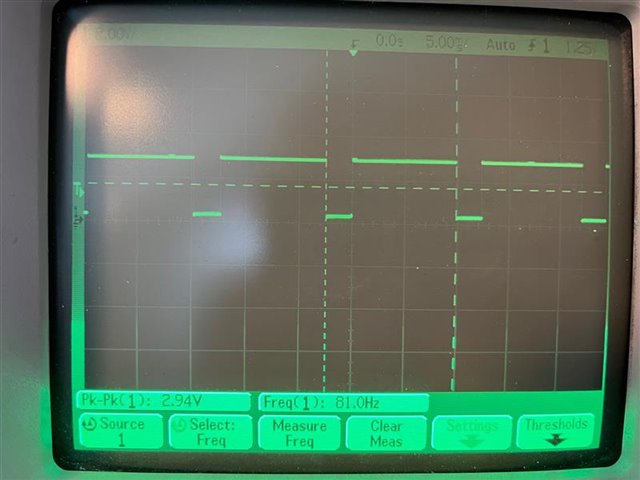

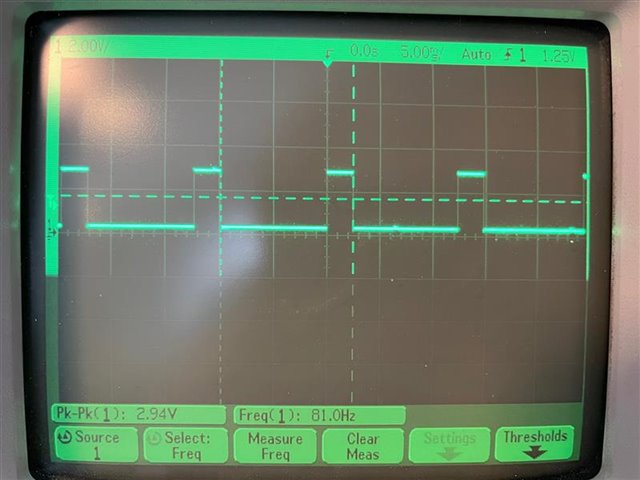

  • Yes, I am able to change the duty cycle. The problem is with the polarity!
    here is the my two signals that I am created for the the following commands, but as you can see, the polarity of the two signals are the same, unexpectedly!
    As you can see, the duty cycle works, but making it OR with 0x8000 will not convert the polarity of the pin!

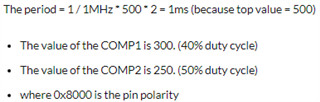

  • In each value, the most significant bit (15) determines the polarity of the output and the others (14-0) compose the 15-bit value to be compared with the pulse generator counter.
    To do this, as you can see in my previous reply and the first picture, I add | 0x8000 to the sequence to change the polarity, but as is shown in the second picture the polarity is not changed! So, the Demo3, that you mentioned, does not work for changing the polarity, as it is also using the 0x8000 command. Using just 0x8000 changes the duty cycle.
    The following link shows the exact code that I am using for changing polarity and the duty cycle but it does not work for the polarity:
    https://jimmywongiot.com/2021/06/01/advanced-pulse-width-modulation-pwm-on-nordic-nrf52-series/

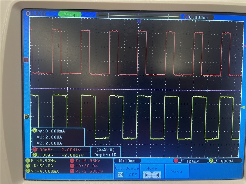

  • Hi
    Using the nRF52840DK (PCA10056)
    I took these two measurements using the following main.c files with the pwm_driver example:

    They look like the same PWM signal, but with opposite polarity.
    Do you get the same results with this code?
    Sigurd Hellesvik
  • Do you get the same results with this code?
    Thanks for sharing the results. Yes, I received the same result and the problem was with the Oscilloscope. Do you have any suggestions, now how I can make arbitrary phase shift the signals? Since by changing the polarity you can have just a 180-degree phase shift.
