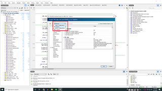

    As I look in my project option there are two options are available one of them is release and the other is common
    How to set the project in DEBUG mode ? [ Please have a look at the below image ]
    The example project here does not have a DEBUG build configuration (probably because of size constraints). So in this case you will have to disable optimization yourself, in addition to define DEBUG (hopefully that will fit in this small device).

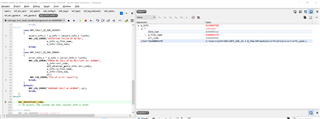

    Then it should be good and you should be able to use a debugger to see what happened by debugging in the error handler. See An introduction to error handling in nRF5 projects. In this case, with DEBUG defined and optimizations you should be able to get this. You may need to do this though:
    Either place a breakpoint in the error handler, or simply let it run to NRF_BREAKPOINT_COND. Then add p_info to watch. Then make an expression of (char*)<address you find for p_file_name when inspecting p_info>. That should look something like this:
    As you see, here there is an error on line 0x2a2 (674) in nrfx_spim.c. You should be able to use the same approach.
    (If you have trouble with this somehow, then an alternative could be to inspect every return value you feed into an APP_ERROR_CHECK() with your debugger.)
