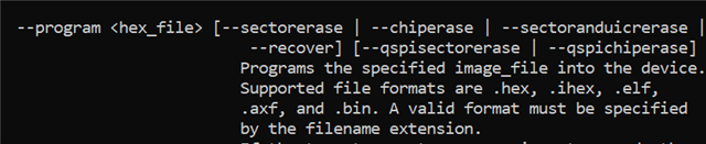

    Thanks for reply. but i can see on the help command that it support for .bin format as well.
    I attached that image below
  • Hehe I actually checked this before I answered, but I guess I have an older version installed than you. This is what mine said:

    If it says that .bin files are supported, then I guess you can just replace the .hex file with the bin file in your nrfjprog command:
    nrfjprog --reset --program blinky_pca10056.hex --family NRF52
    Did you test?
  • Yes i tried it. but didn't work for me as well.

  • Hmm. I also see that it doesn't work using v 10.15.2 external. I'll look into this internally.
