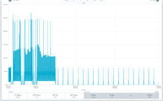

My setup is UDP sample and PPK2 for power measurements. I am trying to figure out the best settings that are available with eDRX set to <= 20.48s, and preferably 5.12 or 10.24. I prefer using LTE-M when available over NB-IoT. PSM is off.
When testing with default UDP sample settings (PSM enabled) i get a very similar power profile to the tutorial (https://www.youtube.com/watch?v=r_dr3Qd8inE). Only difference is in cDRX inactivity timer, i get ~100 ms compared to 300 in the tutorial. All good and normal.

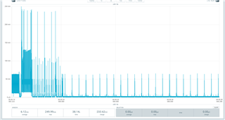

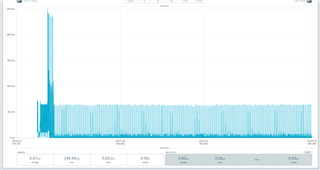

When testing with eDRX i get the following:
  1. the network seems to accept it, meaning i get the callback lte_handler case LTE_LC_EVT_EDRX_UPDATE with the values i set. In one test i set 1110 on LTE-M which is N/A and got back 2621.44 which is the closest value
  2. the power profiler shows an average of 500-600 micro amps with spikes every ~1.2 seconds no matter what eDRX value i set, and even if eDRX is set to "OFF".Also a bit weird since normally with eDRX off i should expect an average current in RRC Idle of ~1 mA (according to Online Power Profiler) and i get about half that.
From the above, to me it looks like i'm getting some pseudo eDRX.

    Can i interpret this that eDRX is off? And if eDRX is on, in RRC mode Idle i should get sleep_enter/sleep_exit with the frequency of eDRX period? Is this how it's supposed to work?
    Yes, unfortunately, this is the case. Your network does not allow you to enter eDRX mode, so you're still in RRC idle mode, which consumes more current.

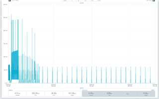

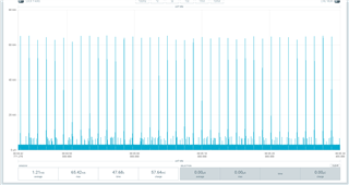

    Coming back on this thread with few updates.
    I tested with 1NCE in Copenhagen and I got real eDRX as measured by PPK2! Slight smile With latest 2022_02_17 fw. Good news!
    It doesn't always work, meaning sometimes I get the LTE_LC_EVT_EDRX_UPDATE event and current consumption is eDRX type, sometimes the callback is not received and modem remains in RRC Idle.
    I get this behavior from the same cell id (reported by LTE_LC_EVT_CELL_UPDATE) on different attempts. Returned PTW can also vary.
