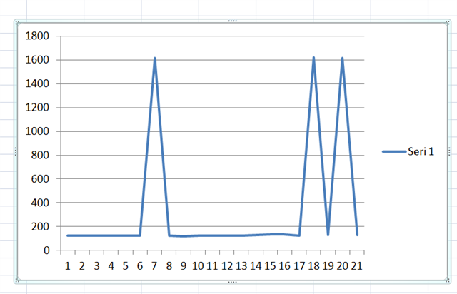

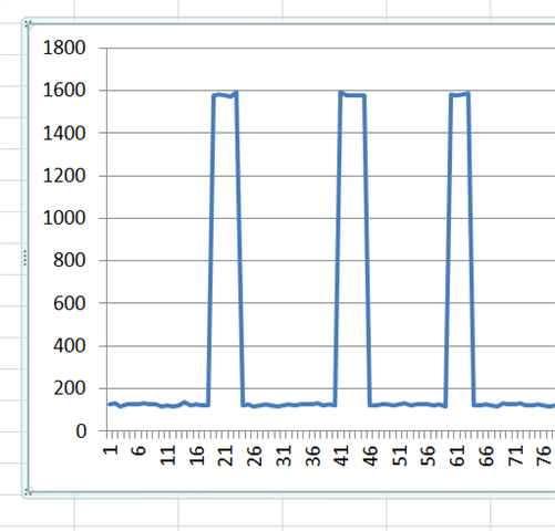

I used this code to convert my analog sensor data to digital with 5 khz continuous sampling  and after that i want to sent my data to pc via BLE. In this code, NUS was used . I am not sure that when the device is not connected with serial port of uart, i can send my data over BLE . How can i check it ? Does nus service send the data via BLE or UART?
While device is connected to nrf connect via dongle , and i see just UUID like this: 43-48-30-3A-20-31-37-37-0D-0A-20 ,Does this ID contains my data , if it contains , Which part of it is my data and how can i convert it a decimal number while i am not connected with serial port.
Also, i tried to convert my digital sample to voltage value, but i cannot print it as float.
float val;
val = (adc_value * 12 ) / 4096;
printf("Val= %f\r\n" , val);
or
float val;
printf("Val= %.2f\r\n" , val);
I couldn't read any float value in my uart terminal. How can i solve this problem?
Thanks...

    I tried to collect sampled data in string and then send the string via ble. I use nrf52840 dongle , to read samples in nrf connect tool.
    The problem is that i can just read one sample after every event occur and the others( other samples in string) couldn't be sent. How can i solve this problem?
    For example,
    I used the square wave for anolog input with 200 Hz , %20 duty cycle and my results can be seen below:
    For Uart:
    For BLE:
    Peak parts should consist of 4 samples but ble just can read 1 sample. How can i solve this problem?
    Thanks...
