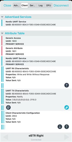

I followed the structure of ble_app_uart__saadc_timer_driven__scan_mode project and customize a program on the nRF52805. I transmit data through BLE to Nordic uart service. I used saadc_callback to send data. However, when receiving data from smart phone, I found that iOS can display the full content(7 values) but Android can only display part of them(6 values). I am not sure why this is happening. Could you help me with this?
I have attached part of my code in ssadc_callback and the output data on two phones. Thanks in advance!

    What kind of Android device are you using for the test?
    It seems like the MTU exchange is not done on this device, and as such each update is limited to the default 20 bytes (the update from the Android screenshot seems to stop at 20 characters).

    I am using the Redmi 9A from Xiaomi. It has the Android version: 10 QP1A. 190711.020.
    The logging line in gatt_evt_handler is not called in Android or iOS. The log only shows these two lines. The first line is from my ssadc_callback.

    I solve the problem by editing the code in nrf_ble_gatt.c  as below:

    The NRF_BLE_GATT_MTU_EXCHANGE_INITIATION_ENABLED is not defined in sdk_config, so when connecting Android the debug output is as below:
    <info> app: BLE Data Sent
    <info> app: BLE_GAP_EVT_CONNECTED
    <info> app: BLE_DEFAULT
    So when I set NRF_BLE_GATT_MTU_EXCHANGE_INITIATION_ENABLED as 1, it solves the problem. The debug displayed output connecting Android is as below:

  • Hi Jeremy
    Thanks for the updated report.
    I should have realized that the issue might be related to the NRF_BLE_GATT_MTU_EXCHANGE_INITIATION_ENABLED define.
    This is a change that was introduced in a recent update to the GATT module where it is up to the application to decide whether or not the peripheral device should initiate the GATT MTU exchange procedure. In older versions the GATT module would always try to do this.
    On iOS this is not necessary since the phone will start the procedure for you, but on some Android devices the phone will not do it and it is up to the peripheral device to do it instead.
    It should not be necessary to change the nrf_ble_gatt.c implementation. All you have to do is set NRF_BLE_GATT_MTU_EXCHANGE_INITIATION_ENABLED to 1 in sdk_config.h:
