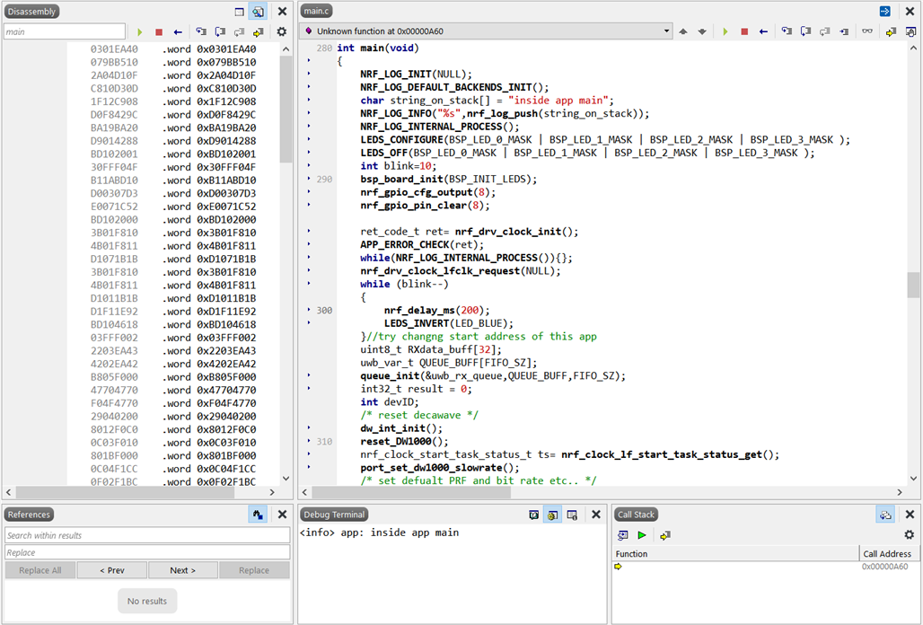

  • The only log that I get in my application is the one that I wrote
    <info> app: inside app main
    the other instance of logging before crushing is in the function nrf_drv_clock_init(), which is not getting processed even if I call NRF_LOG_FLUSH() or NRF_LOG_FINAL_FLUSH()
    but the returned value of nrf_drv_clock_init() passes the APP_ERROR_CHECK
    ret_code_t ret= nrf_drv_clock_init();
    APP_ERROR_CHECK(ret);
    From your "NRF_LIBUARTE_ASYNC_DEFINE", you seem to be using RTC instance 0. This is used by the SoftDevice as well. Try using RTC instance 2 instead.
    I changed the RTC instance to 2, also changed the timer instance to 3, but the problem still persists.
    Is it possible that the address of the modules in use are misplaced in ram?

    Does it passes nrf_drv_clock_lfclk_request() as well?
    Are you able to debug, and figure out where it crashes?
