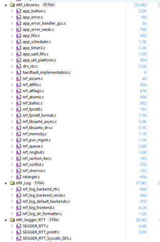

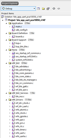

  • Hi Edvin,
    Thanks for your reply. I understand flow you suggested but I stuck in step how to include header file ?
    In Project Explorer window I just find .c file.
    step1 : added the links to the folder which contain .c files in Preferences -> General -> Processors > User include directories
    step2 : then I added .c file by right clicking => add existing file.
    And I don't know where contain header file (.h file) and how to add them ?
    Addititon, How to add Dependencies and Output Files in .c file ? When I add nrfx_ppi.c I didn't find them like nrfx_gpioe.c, nrfx_clock.c....  which are already in ble_app_uart example

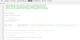

  • Since you only have 3 RTCs, and want to use 1 for the softdevice, 1 for the app_timer, you don't have 2 left to use for libuarte. However, if you look at the definition of NRF_LIBUARTE_ASYNC_DEFINE() in nrf_libuarte_async.h, you can see that if you set _rtc1_idx and _timer1_idx to NRF_LIBUARTE_PERIPHERAL_NOT_USED, then it will use the app_timer instead. Try that.

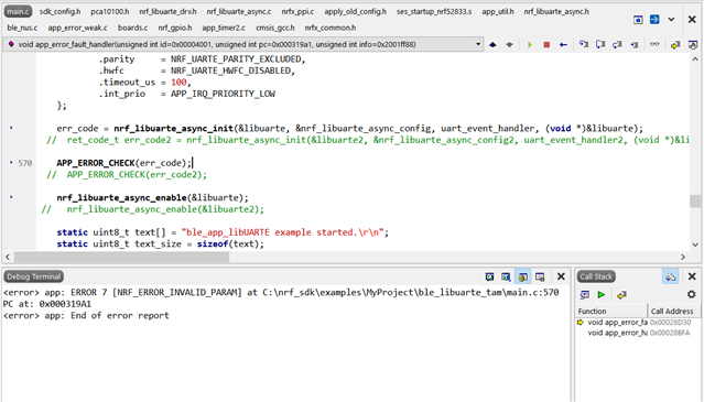

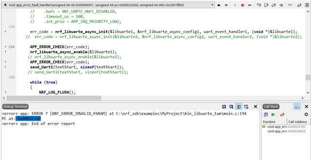

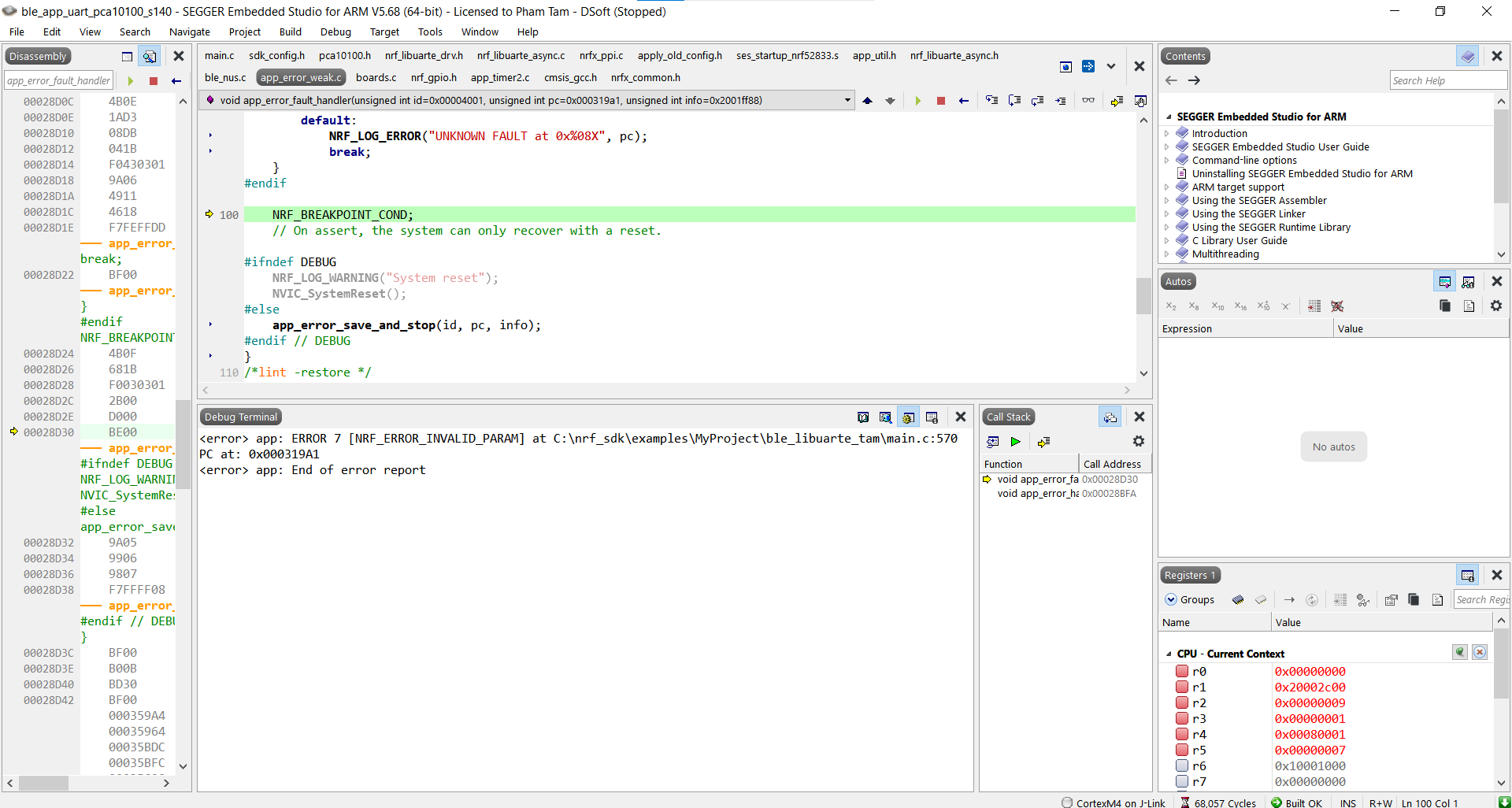

    I got this problem
  • What function returned the err_code that was checked using APP_ERROR_CHECK on l ine 570 in your main.c? And what check inside that function made it return NRF_ERROR_INVALID_PARAM?
    I assume it is related to the initialization of libuarte.
    I used these settings, and it didn't return NRF_ERROR_INVALID_PARAM in my case:
    NRF_LIBUARTE_ASYNC_DEFINE(libuarte, 0, 1, NRF_LIBUARTE_PERIPHERAL_NOT_USED, NRF_LIBUARTE_PERIPHERAL_NOT_USED, 255, 3);
    NRF_LIBUARTE_ASYNC_DEFINE(libuarte2, 1, 2, NRF_LIBUARTE_PERIPHERAL_NOT_USED, NRF_LIBUARTE_PERIPHERAL_NOT_USED, 255, 3);

        err_code = nrf_libuarte_async_init(&libuarte, &nrf_libuarte_async_config, uart_event_handler, (void *)&libuarte);
        ret_code_t err_code2 = nrf_libuarte_async_init(&libuarte2, &nrf_libuarte_async_config2, uart_event_handler2, (void *)&libuarte2);

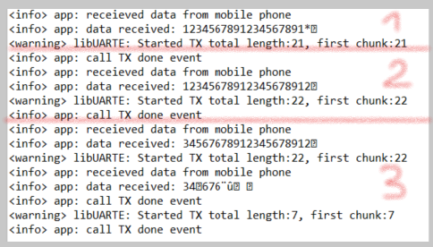

  • Hi, Edvin now I can use 2 libuartes. But I got a problem
    when I used BLE App send to my nRF a string "hello nrf from mobile phone via ble and libuarte"
    Here is my debug terminal and the result show on Hercules
     But in case I send from my Mobile Phone to nRF a short string like "123456789_123456789". I don't get this problem

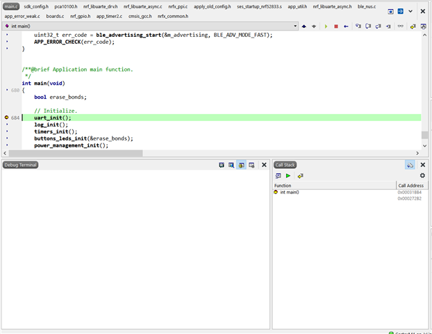

    log_init();
        // Initialize.
        uart_init();
        timers_init();

    In the 1st time I send 1234567891234567891\r\n =>length = 21 => can trasmit data (everything is OK)
    In the 2nd time I send 12345678912345678912\r\n =>length = 22 => can trasmit data (everything is OK)
    In the 3rd time I send 123456789123456789123456789\r\n =>length = 29 => the terminal show weird text
    Her is the debug terminal
    Here is the uart terminal
    Yellow => the 1st time
    Blue => the 2nd time
    Green => the 3rd time
