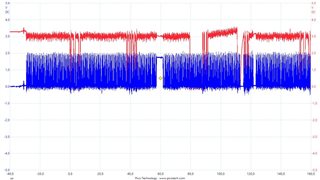

By probing the SWDCLK and SWDIO pins from the JTAG on our custom board (with it connected to the nrf5340 DK), we found that the SWDCLK was stuck at 2V, whereas on a working board the SWDCLK was found to be at 3.3V. Attached is a screen shoot from the oscilloscope where the blue colored wave is the SWDCLK and the red is the SWDIO.
It might be worth noting that we have used the erase function from the nrf VScodes extention on this same device as well as other devices with the exact same hardware many times with no issues.

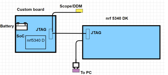

    Can you please provide more details on how you are connecting the nRF5340DK to your custom board? Are both devices powered and ground at same level?

  • Can you please provide more details on how you are connecting the nRF5340DK to your custom board? Are both devices powered and ground at same level?
    The JTAG cable is connected to the board and it is powered by a battery, while the DK is normally connected to my PC. I have checked all the power supplies on the custom board, including the JTAG connector. All of them were at a normal voltage when compared to a working board, except for the SWDCLK which was at 2V as shown previously, so it is not a power supply issue. Additionally, I changed the SoC on that board and everything is now working properly. So, any idea what could have caused it? Again the last thing we did was that erase function!
    I am probing the SDWCLK and SWDIO from the other side of the board while connecting it to the DK with a JTAG cable, if that is what you were asking for.

    The SWDCLK should be provided by the DK, have you measured directly on the DK? Are there any configurations done to the DK? Solder bridges cut or soldered?

    Basically, the nrf5340 SoC on our custom board had a problem with the SWDCLK pin, by measuring resistance on that pin to GND (on the custom board), it was at around 270 ohms without connecting it to the DK. For a working device the SWDCLK pin is at around 12 mega ohms. So with one of our working custom boards the voltage at that pin with the DK connected is 3.3V but for that board (with the initial problem) before changing the SoC it was 2V as shown before (with it connected to the DK). By disconnecting the JTAG cable from our device the DK works just fine (nrfjprog --deviceversion ...etc.), we also tried with several DKs. Again the problem was solved by changing the SoC on our custom board. Since the board was not responding to any command from the DK, and because the SWDCLK goes directly from the JTAG connector to the SWDCLK pin on the SoC on our board, the only option for us was to change it. The nrf5340 SoCs we have are the D revision ones.
    Our custom board is enclosed in a cover with only the JTAG exposed for programing and debugging. It is power by a rechargeable battery.

    Yes with the DK connected its now at 3.3V before it was 2V.
    The problem occurred after using the erase board in the nrf connect extension for Vscode.

  • Are you able to provide schematics and pictures of your setup? Have you had a HW review of the custom board? What about ESD? The issue isn't clear to us, and we will need more information to get to the root cause.
