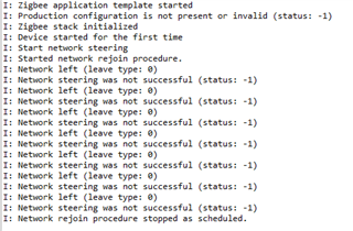

I was implementing ZigBee coordinator in nrf connect v1.18.0 to connect sensor which develops from template sample. every thing went fine until I add install code (took from shell sample). building and running the sample was fine:
  • coordinator side:
ic = "83FED3407A939723A5C639B26916D505C3B5"
zb_secur_ic_add(ic_add_ctx.addr, ZB_IC_TYPE_128, ic_add_ctx.ic, zb_secur_ic_add_cb);
zb_set_installcode_policy(ZB_TRUE);
zb_bdb_set_legacy_device_support(1);
  • ep side:
if (zb_secur_ic_set(ZB_IC_TYPE_128, ic) != RET_OK) {
			LOG_ERR("Failed to set IC");
                else
                      LOG_INF("{0} done setting ic");

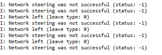

The end device leave network after a second of joining and retry joining network!
RTT of coordinator:
RTT of endpoint:
why the ep leave network Error message (Network left (leave type: 0))? is there something I must add?

    In the log on the coordinator it says that it failed to parse eui64. Are you certain the address you give as parameter in zb_secur_ic_add() is correct? Are you using the Zigbee shell sample and issuing shell commands (such as bdb ic add), or have you copied the relevant code from the shell library to your code?
    Can you try to read and print the install codes stored on the coordinator to see if they have been added correctly?
    In the log from the sensor I do not see the result of setting the install code. Does is say that it failed to set the install code, or does it print "done setting ic"? Remember that on the joining device you must set the install code before the stack is started, so before zigbee_enable().

    I have fix problems of parse eui64 and store ic correctly also, set ic code in ep before the zigbee_enable()
    yes I was able to list ic which include the correct install code with eui64 of device. However still get the same error (I: Network left (leave type: 0))!
    the device try to join to coordinator but leave at same time and re join again and leave  at same time!
    I doesn't know what the problem is!

    After some experiments I found that I was adding wrong long address of sensor in the coordinator. the sensor join the network after adding its own extpanid !
