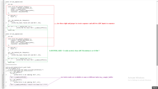

  • Hi, I created an application for testng the sampling of 2 channels on AIN0 and AIN1. The files are attached. I have few doubts.
    1. In the adc.h, is  #define  BUFFER_SIZE 2  right or wrong to sample 2 analog channels ? If in future, 3 chhannels are required, may I set #define  BUFFER_SIZE 3.
    2. In the main file, I adc instantiated by binding and then, set up channels using err = adc_channel_setup() .. function. Is it proper way ?
    3. As, I copied the most coe from sample program, what is meaning of following ?
    #if defined (CONFIG_BOARD_BMS_NRF5340_CPUAPP)
    NRF_SAADC->TASKS_CALIBRATEOFFSET = 1;
    4. I wrote two sample functions, as in adc.c. Is this proper way to add to sequence ? If, wrong any where, may you make changes and attache corrected code file ?
    5. I called adc sampling functions in repeatitive timer. Is the result of adc from AIN0 and AIN1 be avaialble at same index or at different indices in p_sample_buffer[].

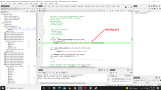

              adc_dev = device_get_binding(ADC_DEVICE_NAME);
                  if (!adc_dev) {
                  printk("device_get_binding ADC (=%s) failed\n", ADC_DEVICE_NAME);

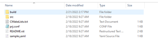

  • Hello Gulzar,
    I have started looking at your files. Could you please send me the whole project so I can try to reproduce it?
    Best Regards,
    Kazi Afroza Sultana
  • Hi, here is the code in attached file.
    #include <hal/nrf_saadc.h>
    #define ADC_DEVICE_NAME DT_LABEL(DT_INST(0, nordic_nrf_saadc))
    #define ADC_RESOLUTION 10
    #define ADC_GAIN ADC_GAIN_1_6
    #define ADC_REFERENCE ADC_REF_INTERNAL
    #define ADC_ACQUISITION_TIME ADC_ACQ_TIME(ADC_ACQ_TIME_MICROSECONDS, 10)
    #define ADC_1ST_CHANNEL_ID 0
    #define ADC_1ST_CHANNEL_INPUT NRF_SAADC_INPUT_AIN0
    #define ADC_2ND_CHANNEL_ID 1
    #define ADC_2ND_CHANNEL_INPUT NRF_SAADC_INPUT_AIN1
    int err;
    static int p_sample_buffer[BUFFER_SIZE];
    const struct device *adc_dev;
    static const struct adc_channel_cfg m_1st_channel_cfg = {
    	.gain = ADC_GAIN,
    	.reference = ADC_REFERENCE,
    	.acquisition_time = ADC_ACQUISITION_TIME,
    	.channel_id = ADC_1ST_CHANNEL_ID,
    #if defined(CONFIG_ADC_CONFIGURABLE_INPUTS)
    	.input_positive = ADC_1ST_CHANNEL_INPUT,
    static const struct adc_channel_cfg m_2nd_channel_cfg = {
    	.gain = ADC_GAIN,
    	.channel_id = ADC_2ND_CHANNEL_ID,
    	.input_positive = ADC_2ND_CHANNEL_INPUT,
    static int adc_sample1(void)
    	int ret;
    	const struct adc_sequence sequence = {
    		.channels = BIT(ADC_1ST_CHANNEL_ID),
    		.buffer = p_sample_buffer,
    		.buffer_size = sizeof(p_sample_buffer),
    		.resolution = ADC_RESOLUTION,
    	if (!adc_dev) {
    		return -1;
    	ret = adc_read(adc_dev, &sequence);
    	if (ret) {
    //        printk("adc_read() failed with code %d\n", ret);
    	for (int i = 0; i < BUFFER_SIZE; i++) {
    //                printk("ADC raw value: %d\n", p_sample_buffer[i]);
    	return ret;
    static int adc_sample2(void)
    	int ret;
    		.channels = BIT(ADC_2ND_CHANNEL_ID),
    	if (!adc_dev) {
    		return -1;
    	if (ret) {
    	return ret;
    void my_work_handler(struct k_work *work)
    {int err;unsigned int k;
        /* do the processing that needs to be done periodically */
    //********** AIN0 Sample part **************
           err = adc_sample1();
            if (err) {
    //            printk("Error in adc sampling: %d\n", err);
            var1 = p_sample_buffer[0];
           err = adc_sample2();
            if (err) {
            var2 = p_sample_buffer[0];// should it be index 0 or 1 ?????
                  if (!adc_dev) {

  • I mean the project folder which contain build file, configure file, cmakelist text file and source file. like the following screenshot:
  • Hi, I just need answer of three queries as shown in attached image.
