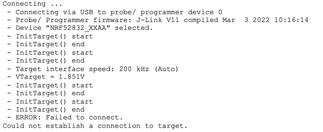

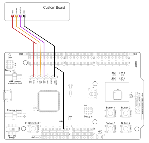

I know this question has been asked a lot. But I haven't found one that matches exactly. I'm trying to flash a custom PCB with an nrf52832. I'm using the on board flasher of the nrf52 dev board using the setup below.
My battery is 3.7v and I have a buck regulator that brings it to 1.8v to operate the nordic mcu. However, the vdd referenced in the above diagram is connected to the battery line directly and therefore reads 3.7v. I'm not sure why the flasher is not recognizing the custom board.
Could it be the mismatch between voltages (1.8 for mcu vdd and 3.7 for flasher vdd)?
If you guys can point me in the right direction I would be very much obliged. Let me know if you guys need any diagrams or layouts for clarification.
I'm using sdk 16.0.0.
