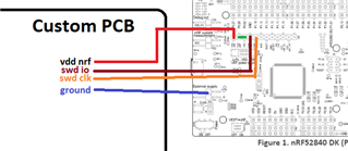

  • Hey Ryan,
    Could you expand a bit on how you are programming your board? It would be great if you could show a picture of the setup as well.

  • Hi Elfving,
    I've made a diagram! At the time I used the following setup:
    In addition, I powered my external board's VDD with 3V and had the dev kit plugged into my computer's USB. In retrospect, this was really dumb since I probably caused some contention on my VDD_nrf wire...
    In my current (working) setup, I'm no longer powering my custom PCB externally. I'm simply running everything off of the dev kit's VDD_nrf (that ultimately comes from my computer's USB).
    I've read that I can erase/recover chips using the nrf connect app on my computer. Does that seem like the next step to 'unbricking' my custom pcb's nordic? If so, can I erase/recover my custom pcb's microcontroller by using the above setup (without externally powering the custom board) and running the nrf programmer from the connect app?

    Your setup looks fine in my opinion.

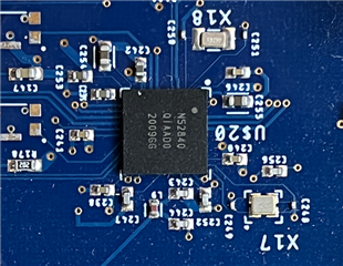

    What SoC are you using on the custom PCB? Could you send me an image of the PCB?
    It's one of the 7mmx7mm QFN packages!

  • Hey Ryan,
    If this is not an issue on the DK there might be something wrong/different on your PCB.
    Can you measure the voltage at the reset pin and VDD at DUT directly at the custom board?
