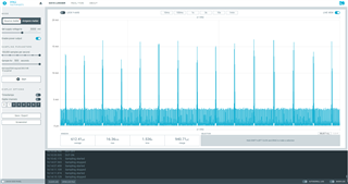

I just got my PPK2 and wanted to test it on the nrf52840
It seams to work fine, I can see the advertisement peaks, however the average power consumption was too high. I tried different configurations but ther was always a noisy average power consumption of 0.6mA to 1.4mA (depending on the configuration I tried)
After some bugfixing i found this post and tried the configuration there https://devzone.nordicsemi.com/f/nordic-q-a/82804/nrf52840-ppk2---source-meter-vs-ampere-meter/344105#344105
That is:
Source meter mode:
  1. Power the nRF52 directly from P21 by using the SW10 (VEXT -> nRF)
  2. If SB40 is previously cut, put a jumper on P22.
  3. The USB should be left connected in order to power the rest of the DK (otherwise you will get leakage through the SWD interface)
  4. The nRF ONLY switch (SW6) should be set to nRF ONLY to avoid leakage currents
As software example I used the Peripheral_hr example of the nrf connect sdk 1.7.1
in the prj.conf I set  CONFIG_BT_DEBUG_LOG=n, though I think that did not change anything
Here is a picture of the PPK2 result
I also tried the amperemeter solution but i got a similar result
I hope I provided all needed informations
br
Julian

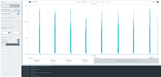

  • small update, flashed the program for testing on a NRF52840 dongle (PCA10059) and connected the the PPK2 with source mode directly to the Vbus and ground pin.
    Here the results seem to be more reasonable (see picture), at least i don't have this strange noise and way less average current
    Maybe I am using the DK wrong :-/

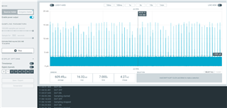

  • Hey, thanks for your reply
    As I already wrote i also tried the Ampere Meter Mode.
    Here is a Screenshot of the power profiler and how i did the cable connections (I hope you can also see the board configurations/switches)
    Power Profiler:
    Connection with board:
    (both (PPK2 and DK) are connected to the computer
    br
    Julian
  • Hi Julian
    Yes, you said you had tried in Ampere mode, I just wanted to make sure it was connected correctly in Ampere Meter mode as well, and it seems like it is. There's some reflection on the solder bridge which makes it hard to see if it is cut correctly, but this wouldn't be the behavior you would see with an uncut SB40. Have you tried power cycling the board after programming it with the CONFIG_BT_DEBUG_LOG=n config? That's necessary to exit the "debug" mode on the DK. Try turning the board off, removing all power sources to the DK, before attaching them and turning the board back on.
    Simon
