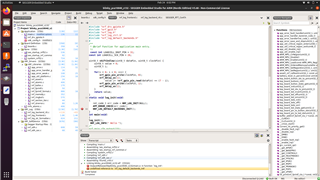

I am using nRF52840 DK and Segger with nRF5SDK 17.0.2 version. There are many examples that prints a NRF_LOG_INFO(). But I want to understand how to configure by myself. So I was trying to implement.
So I have added a below header:
#include "nrf_log.h"
#include "nrf_log_ctrl.h"
static void log_init(void)
and called it in main function
log_init();
 NRF_LOG_INFO(" Hello ");
Added nrf_log_backend_rtt.c file in nRF_Log folder Also defined below in sdk_config.h file
#define NRF_LOG_BACKEND_RTT_ENABLED 1
#define NRF_LOG_ENABLED 1
But still I am getting below error:
SEGGER_RTT_Conf.h: No such file or directory
Also I was checking on forum about the same error and people asked to add ../../../../../../external/segger_rtt; In user include directory but I have also tried to do the same. But got another error
undefined reference to `nrf_log_default_backends_init'
I am not sure what I am missing to do?
I am attaching the screenshot for reference.
Please help me.
Thanks in advance.
Thanks and regards,
Neeraj Dhekale
    You said you are using nRF52840DK, but the project in the figure is blinky_pca10040_s132 which cannot run on nRF52840DK. I would suggest you use nRF52832DK for blinky_pca10040_s132 or use the projects for pca10056 (nRF52840DK)
    According to the figure, seems it needs the following:
    1. Adding source files
    Including header files
    2. Adding configurations for NRF_LOG_BACKEND_RTT and nRF_Segger_RTT to sdk_config.h

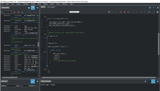

    3. main
      log_init();
         while (true)
            NRF_LOG_FLUSH();
            __SEV();
            __WFE();
            __WFE();
            // no implementation needed
    Then, you could get the log.
    Test file: blinky_284808.7z, place it under nRF5_SDK_17.1.0_ddde560\examples\peripheral
    Amanda
