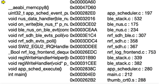

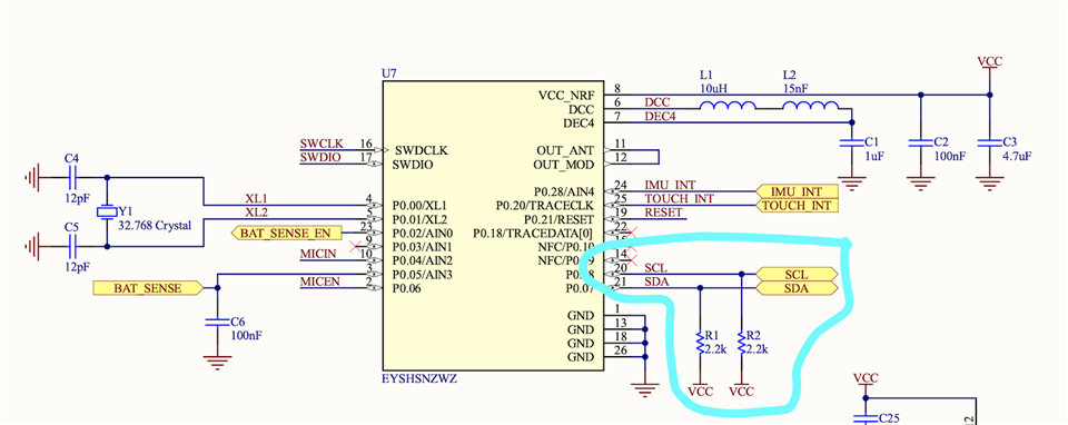

Until recently, I have had no issues using the TWI module to read/write form all of our various sensor ICs that we have on our custom board. I initialize each sensor and configure them using TWI and it behaves as expected. After initialization/configuration, my application begins to advertise, and when it connects with our Desktop app it continuously streams data from each sensor every 50ms according to a repeated timer. This timer makes use of the App Scheduler by calling app_sched_event_put(NULL, 0, dataSamplingTimerHandler) every 50ms, and this dataSamplingTimerHandler reads from each sensor IC using TWI before it sends each byte of data using ble_nus_data_send(). This timer and ble-send functionality also works as expected, with no issues and we receive the data nicely.
Now that this behavior is stable, I have set up some code to receive incoming BLE commands in the nus_data_handler(), which also makes use of the App Scheduler and app_sched_event_put(), so that I can read/write to sensor registers directly from the Desktop app. My goal is to hopefully lean on the Scheduler to securely queue and manage TWI sensor-read events from the internal timer and from these asynchronous incoming BLE commands so that there is no resource conflict or anything like that.
The code I wrote (included below) works without fail when I am simply reading from a register. However, it only works some of the time when I want to write to a register. When it works, I can successfully verify the data was written by reading from the register.
When it fails, it throws NRF ERROR INTERNAL, ERROR # 3, pretty much every single time. When only requesting a single ble-enabled register write operation, it is much more likely to avoid the error than if requesting a batch of multiple register writes. I have tried changing the I2C frequency from 400kHz to 100kHz and this doesnt help. Do you have any ideas as to why the register write operation fails only when it is triggered from the incoming BLE message? I have also included a photo of the stack when the failure occurs. Please let me know if there is anything else (other code?) that I can add to this ticket to help debug this. Many thanks in advance!

  • This may be due to not considering multiple threads, which is an issue I have seen on other projects. regWriteHandlerHelper() is (probably) not re-entrant, so an error is generated when it is used by two threads simultaneously. Why would that happen? Consider a read or write in progress to the sensor from some function invoked from main or other part of the code when a BLE packet is received asynchronously which invokes nus_data_handler(). The problem is that this BLE request is within an interrupt context, and so initiates a sensor transfer interrupting the transfer already in progress with no handling to detect this.
    A simple test to see if this is the issue is instead of nus_data_handler() invoking regWriteHandlerHelper() directly instead set a volatile bool and invoke regWriteHandlerHelper()  from main().
    If you have already considered this please ignore, but looking at the code presented in the original post it looks like this is the issue.
  • Correct me if I am wrong here, but I am specifically using the app Scheduler to deal with this issue of multiple threads. My understanding of the Scheduler could be incorrect, but from the main() function in my project, the application is in an infinite loop that solely waits for events and calls app_sched_execute() to run any tasks that have been queued via app_sched_event_put().
    By only scheduling (not running) the register write task in the ble_nus_handler(), I thought that I was effectively handing off the execution of each regWrite task to the main() loop. The only other reads/writes made to the sensors are also done via the same app_sched_event_put() function, so my hope was that the Scheduler would be smart enough to sequentially process these tasks without conflict or fear of asynchronous interrupts.
    Is this logic incorrect?
  • You are correct, I re-read the code more closely and see that I'd missed that.
    The TWI always had an issue (MISRA and CERT violation) with using an unchecked length to create an array which is subsequently used by an unchecked block copy/move. if length is (say) 0 bad things happen .. edit ignore that I see there is a +2 on reading again. Is pdata range-checked? memcpy of a zero-length value is also bad .. and the error shown seems to be in memcpy ..
  • In the code I posted, specifically for the register write function, execution makes it all the way until the first APP_ERROR_CHECK() function catches the NRF INTERNAL ERROR 3. It does call memcpy right before interfacing with the TWI library, but there havent been any failures from memcpy to my knowledge. As Jared (from the other comment) mentioned, it is looking like a hardware and timing issue with the TWI driver, and thankfully it looks like I figured it out. I needed to gracefully handle the expected TWI NACK from forcing the communications window with my sensor...it appears the NACK followed by an immediate write or read would cause issues with the timing? Not really sure, but it seems to have helped. And I added a few delays in between operations to give a little more slack in regards to timing.
    However, checking for a non-zero length of incoming data is a good check to have in place, so thanks.
