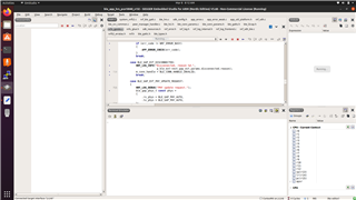

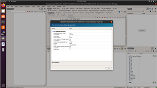

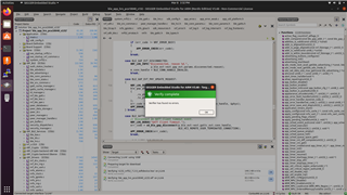

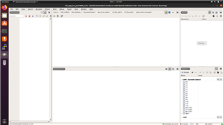

  • Hello Hung Bui,
    I have tried to implement fstorage but I am facing issue with in ble_stack_init () function for nrf_sdh_enable_request() function returns 8. Did you face this issue? If yes, What did you do for that?
    Also I tried to comment BLE related all function then it is showing below error:
    nrf_fstorage: addr_is_within_bounds(p_fs, dest, len) check failed in nrf_fstorage_write() with value 0x10.

    Actually, I have tried with your code. But I have checked on the terminal as well as on debug terminal. But I cannot see anything.
    So I cannot check whether it is actually saving and displaying saved value.
