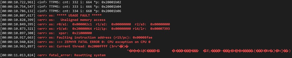

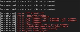

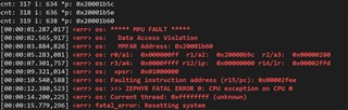

The I2C itself seems to work fine writing and reading, but then when the read data is copied from a char array in the I2C function (1664 length) into a uint16_t array in main() (832 length) I always get the same crash, when the pointer to the uint16_t reaches address 0x20001b60. Using printk and addr2line I traced the problem to line 86 in MLX90641_I2C_Driver.c, where the data is copied inside a for loop.

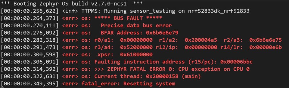

When I try setting CONFIG_MAIN_STACK_SIZE=2048, I instead get a "Bus Fault" before the program even prints anything. The crash address is traced to the zephyr uart_console.c line 94.

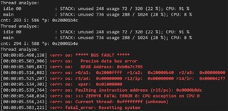

I then removed the stack size config and tried using the Thread Analyzer, which causes a bus fault traced to the zephyr kernel thread.c line 946 and thread_analyzer.c line 84. The thread analyzer output shows the thread stacks aren't anywhere close to overflowing.
I am pretty stumped here and would greatly appreciate any help. Thanks!
  • As stated in the original post, increasing CONFIG_MAIN_STACK_SIZE causes an immediate bus fault crash and the program does not even start. I just tried reducing the CONFIG_MAIN_STACK_SIZE to 512 (default is 1024) and now the program got further along (cnt: 575) but it crashed at the exact same memory address, 0x20001b60. I am now almost certain this is an issue with Zephyr/NRF52833 memory regions rather than faulty code. Sidenote: I'm now using LOG_INF with LOG2_MODE_IMMEDIATE instead of printk.
  • I've now tried dynamically allocating memory, and I get a bus fault.

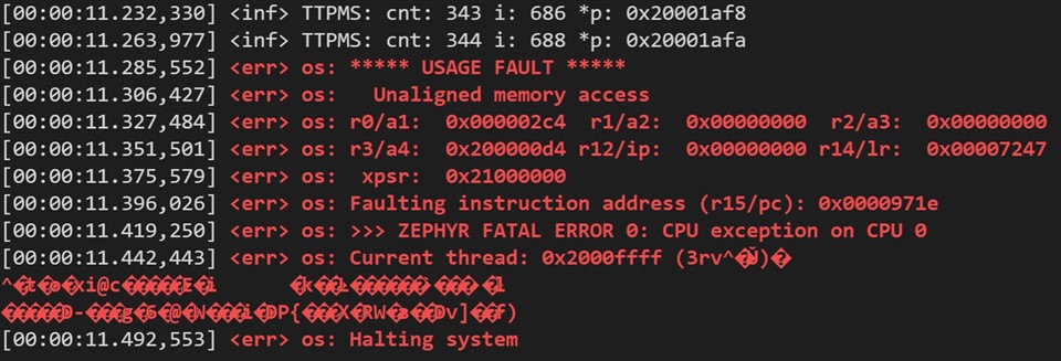

    Log output:
    addr2line on r14/lr: 0x00008047 goes to SEGGER_RTT.c line 948
    Interesting to note that the crash happens before the program even gets to LOG_INF on the first line of MLX90641_I2CRead
    UPDATE: If I include string.h in main.c, the crash turns into an MPU_FAULT but happens at the same address traced back to SEGGER_RTT.c
  • I randomly added another LOG_INF output outside of the function that crashes, and the crash changed to "Usage Fault" and it seems the function gets slightly further along although the crash happens at a lower memory address as can be seen below.
    Instruction addresses traceback to random NRF/Zephyr files.
    And now, even weirder, when I comment out everything below line 24 in main.c, the program does not run at all and crashes with another different message seen below. How is this possible if the crash happens in the first function? I don't see how removing code after this point should change anything, since it never even runs. It must be some obscure ridiculous memory issue causing these crashes?
    Once again, the faulting instruction addresses in r15 and r14 trace back to random zephyr code (log_output.c and cbprintf_complete.c)
