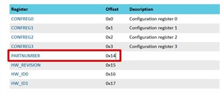

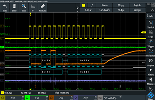

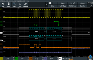

First, I try to read the Partnumber. When I set the power dowen off, the SPI signals are ok, but of course I have no feedback from the MISO.
yellow is the SP I Clock, green is MISO, orange is MOSI, lila is ChipSelect
Signals ok:

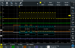

As soon as I set PowerDown = ON = nRF21540 enabled, the second SPI MOSI pulse is there, but really low (nRF21540 pulls down the level!)
What is the reason of this and how this can be solved?
