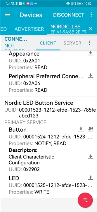

  • Hello, Vidar
    Here it is. Done what you asked, have never seen LED3 on on my nRF52DK board. I use Mobile app on Andoid devive.
    Thank you.

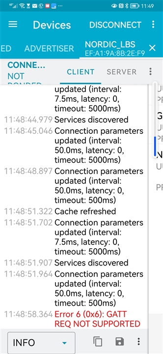

  • Hello Ping,
    You can swipe right to view the log after you have attempted to write to the LED characteristic. Can you post a picture of the log as well?
