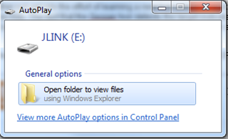

    5. Every time the Dev Kit is connected to the computer, the computer detects the device as an external drive as shown below:
    Thanks for your help, best regards

  • Hi Claudio,
    Which Windows version are you using?
