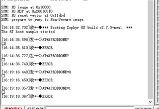

In addition,AT%XRFTEST command is blocked, how to restore it?

Hi:
AT%XRFTEST return error
THANKS!!
JERMI.JIN
Have ensured that your device is not configured with XPRODDONE? From the description you provide it does sound like this is the case.
From %XPRODDONE documentation:
The set command disables R&D features by closing the modem Universal Asynchronous Receiver/Transmitter (UART) connection and optionally permanently disables the use of the %XRFTEST and %XEMPR commands. The command also permanently enables the downgrade prevention of modem firmware.

Hi:
How can I enable XRFTEST ?
