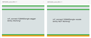

Goodday all
Im experimenting with Vscode and Nrfconnect (zypher library). I want to see how easy it is to port my Segger nrf SDK code to vsCode.  Having trouble getting it to work (with my custom board based on modified dongle board files) I thought let me first just try the blinky example. which also did not work.
Is the blinky example suppose to work out the box? In my application build I select nrf52840dongle_nrf52840. I program the dongle via my 52840DK.
Currently if I flash the blinky example im just getting the pulsating red led. I can see its flashing the dongle as it resets after the programming is complete.
Thank you
    What is your VS Code version and your nRF Connect for SDK version?
    Priyanka
  • Morning Priyana
    nRF connect v 3.10.0 and vscode 1.65.2
    Could you provide the build logs that you get when you do this? Are there any problems displayed on the output console?
    -Priyanka
  • HI, build log below. No error at all. Thats why I was wondering if anything in the board files need to be manually edited .

    Does this happen only when you try via the DK? Did you try to program the dongle via the Programmer App?
    -Priyanka
    If I use the programmer (nRFConnect) to burn the zypher.hex  ( dongle bootloader) it is working. But not through the DK. Let me try another DK and revert back.
  • Good Morning,
    I have tried another DK and results are the same. I can program the dongle with Blinky through Nrf Connect via the dongle bootloader or the DK and the Zypher.hex  Blinky code works. But if I do it through VS then the dongle resets after programming th  pulsating red LED stops flashing but that's it. Its as if the App is not running. if I press reset button it goes back to bootloader mode.
  • Good Morning,
    It does look strange. Are you facing the issue only with VS Code or with SEGGER and west too?
    -Priyanka
  • Only with Vs code.I have not tried Segger through nRF connect will try this afternoon. I normally use Segger SDK and that works 100%
  • Please do keep in mind that when using the nRF52840 Dongle you have to build different images if you use the Bootloader or if you use a programmer to get the program onto the device. This is caused by the MBR which will be present in the device when using Bootloader and not when not using bootloader resides in the first 4KB of the flash. This means target needs to either reside after this or at address 0x00000000.
    Depending on how you set up the project in DTS this will work for one of the platforms but not both. Have you changed the build for the different versions or do you add the MBR to the hex file when using the JLINK/DK to program the dongle?
  • Not sure what you mean with DTS. but I have taken a fresh dongle with bootloader. Connected it to my DK and flashed it through nRF connect with vscode and Segger. Segger works but they look the same, so not sure why vscode does not work
  • So you mentioned the use of a nRF52840-DK earlier on.
    there are 2 ways to program the nRF52840 Dongle
      Use the built in DFU over USB, requires code set up for existence of MBR, code starting from 0x1000
      Use a nRF52840 DK (or other debugger) programming through SWD, requires code set up for no MBR and starting at 0x0000
    placement of code is set in .dts files when using the nRF Connect SDK, this is the device tree files.
    so how do you program the nRF52840 Dongle?
    Check what configuration you have for the flash placement, that should tell you if the code built should run with the programming method used.
