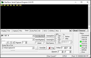

  • Hi, Håkon
    I had a look on the hci_uart example, looks like it initiated a UART0  with 4 pin hardware flow control ans seems able to receive and transmit some sort of cmd/data over the UART0 , I have no knowledge of the protocols used here,  may I modify it to use UART1 on nRF52833 with 2 pins without modify the software?
    I am also struggling to interact with it - lost in the ReadMe.lst file, I am a windows user and has been advised to user VS Code so far, if there a way I see it in action?  like with a terminal program? if it use UART0, then it should be able to communicate with Terminal program, what kind of command/messages shall I send to work with?
    Regards!
    Ping
    The HCI interface is not designed to be used from a terminal, but if you can configure your terminal in binary (hex) mode it is possible to send and receive some simple commands.
    Using RealTerm I tried sending the reset command to an nRF52DK flashed with the hci_uart sample, and got a response:
    I haven't read the HCI spec to see what the response means, but if you can get something similar it means the UART communication works.
