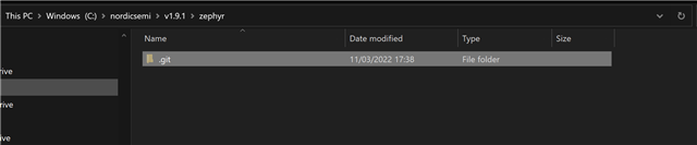

Extension are installed like in the Video. In video 2 (link above) examples from zephyr folder from SDK are used, which I am too unable to find or select.

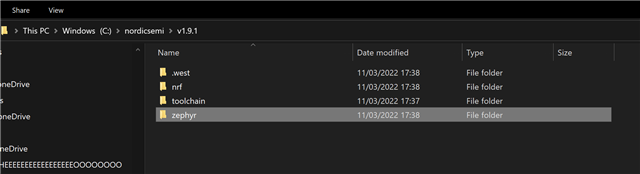

Directore where SDK is saved
I found

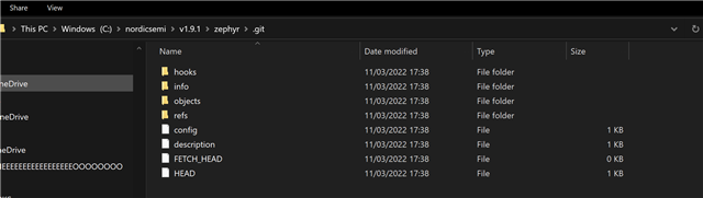

    Did you install the SDK and toolchain with the Toolchain Manager? If so, are you using VPN or on a network with a strict firewall, such as a company network? The reason I am asking is that I see that you have multiple missing folders inside v1.9.1, so not everything was downloaded and installed correctly. This can happen when using VPN or being behind a strict firewall when downloading. If you use Toolchain Manager the v1.9.1 folder should contain the following:
    v1.9.1
    ├── bootloader
    ├── mbedtls ├── modules
    ├── nrf
    ├── nrfxlib
    ├── test
    ├── toolchain
    ├── tools └── zephyr
