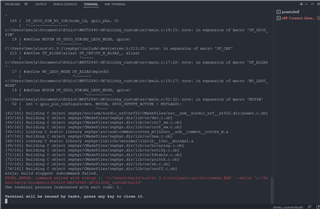

    This error happens when first building the file:

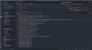

    Trying to build the file similarly gives some errors:
    Looking through the code, my guess of some possible errors are:
    • in line 52 of the main.c, it should be 'dev2' not 'dev' inside gpio_pin_configure()
    • in line 8 of the .overlay file, it should be 'myled1 : led_1' instead of 'myled0led1 : led_1'
    • in line 17 of the .overlay file, it should be 'myled1 = &myled1' instead of 'myled1 = &myled0'
    - though it is entirely possible I'm misunderstanding the code layout.
    I also noticed the .overlay was labelled as 'nrf52dk_nrf52832.overlay' which I assume should be changed to 'nrf52840dk_nrf52840.overlay' for my specific board? I think that was at least part of the problem as the .overlay is now showing up in the device tree interface

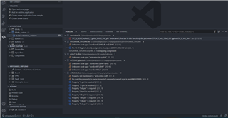

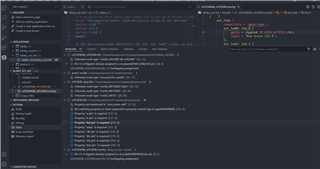

    There are still warnings when it compiles, but I'm guessing these are all fine?:
  • Hi Benjamin,
    Did it work ? Do you see any voltage on the pin ?
    I don't think it's an issue with the warnings from VS Code. What's important is if the log in the compiler terminal show any error or warning.
