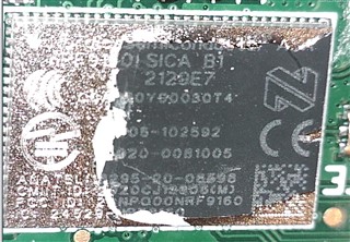

Removed metallic cover of nRF9160 SiP
We tried to remove a component that was glued to the top of the nRF9160 SiP and accidentally removed a bit of the SiP's metallic covering (see pic attached). Our guess is that the metallic cover might be there for EMI/EMC protection but we'd like to confirm if removing this film has damaged the SiP?
Robert
  • Hi Robert
    The SIP should work fine despite a bit of the covering going off. The nRF91 chip itself and the various passive components are covered in epoxy, and it will take more damage for them to be affected.
