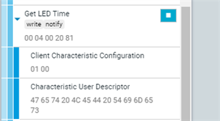

The problem is it returns the wrong data.
I am expecting: 02, 01F4, 07D0 ( as output by NRF_LOG_INFO() )
I am getting: 00 04 00 20 81 ( as displayed by nRFConnect ) This never changes and I see the same values on other Characteristics that do the same thing

    I print in 2 places, the on_write() and  SendNotify(), the commas are not printed no, here's whats actually printed: I've changed the value 01f4 to 03E8  for other reasons....
    nRFConnect should show "(0x) 01-07-D0-03-e8
    <info> MTserv: BLE_GATTS_EVT_WRITE: 60<
    <info> MTserv: LED Time, 1, 03E8, 07D0
    Notify, 0, 0107D003E8
    the data buffer looks correct ( same data as notify )
    I'm using nRF connect on the PC, but tried it on my phone with the same results(0x) 00-04-00-20-81
    This is from the PC
