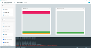

Failed to write: Timeout while waiting for device E9C685ED215E to be attached and enumerated
I am using nRfdongle(nrf52840dongle), Getting timeout error while writing new .hex file to the dongle.
Using nRf programmer app write new .hex file to the dongle. have taken .hex file from the nrf_sniffer_for_bluetooth_le_4.1.0 file.
Steps:
1. Open programmer App
2. Connect the dongle to the PC
3. Reset the dongle
4. Red led is blinking in dongle
5. Select the dongle in drop down
6. Add .hex file
7. Click on Write hex file
Observing result: Getting timeout error after writing 100%
    That is the expected behavior. The device will reset when the upgrade completes and the dongle will no longer show up in nRF Connect unless the application used DFU Trigger Library is used, as it is no longer in DFU mode. You will get an error stating "Reopen device failed" in this case, and have to push the RESET button in order to make it show up in nRF Connect Programmer again.
