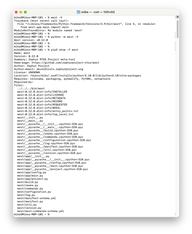

    • Except for one item, which has been experienced on all macOS installations.  Despite what's (implied?) in the documentation, there is no command line launcher for west.  West is not an app, but a Python module.  Normally in such cases, there is a small executable app, a stub, which when started launches the module.  I've found no such stub in the west directory or related files.  Am I missing something?
    As noted in the attached terminal log, "west" is not a recognized command, but "python -m west" (i.e., invoking it as a module) works everywhere.

    Surprising that this issue doesn't cause more extensive problems.  At the moment it has halted my progress with the manual SDK next step, setting up SES.  I need to enter the pathname of the west executable in the SES configuration, but there is no such file apparent.

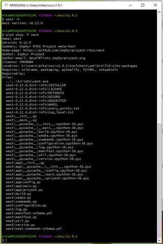

  • Results of Further Testing:
    • My Windows 10 VM was broken. Built a new, clean Win10 VM (64-bit), installed nRF Connect for SDK Desktop app, Tool Manager, SDK 1.91.  All went without error!
    • From an "Open Terminal" window, it is possible to demonstrate that the west.exe stub does exist and west can be invoked directly from the command line, both of which can be seen from this screen shot.
    • SES launches properly from clicking the "Start SES" button in Tool Manager.
    • The Project Options pane opens without error from the "File | Open nRF Project..." SES menu command.
    • Solution nrf_ dm on nrf52840dk_ nrf52840 generated and built OK
    • Solution nrf_ led matrix on bbc_ microbit v2 generated and built OK
    In other words, everything worked as it should on Windows 10.
    In contrast, I should note:
    • Here's the corresponding terminal output regarding the configuration of the west module on my MacBook Pro running macOS Monterey:
    • Note that a "west.exe" doesn't exist (That's a Windows app), but a "west" file does exist at pathname "../../../west"
    • Converting to an absolute path, that's: /Users/mike/.asdf/installs/python/3.10.0/bin/west
    • That's inside a directory controlled by the asdf virtual environment system I'm using to control multiple Python versions (a multi-language tool more general than env) and, unfortunately, not in the right place to be executed directly from the command line.
    Not sure how to correct this yet, but it certainly points to a problem with west execution in my particular macOS environment.
    Not sure yet if all of the issues I've encountered are due to this one cause, but fixing it is certainly a good place to start.  I've noted that your online docs now(?) include some comments about use of venv in the Mac environment.  Would be great if you could get together with one of your Python experts to sort out what the proper nRF SDK installation procedures are in a complex Python environment.  I suspect this isn't just a macOS problem, just where we've first encountered it.
    I'll work from my end, but I'm neither a venv or asdf expert.  Just give me some suggestions and I'll try them out.  I suspect this will result in some extra cautions in the documentation or even changes to the installation code.
    Mike
