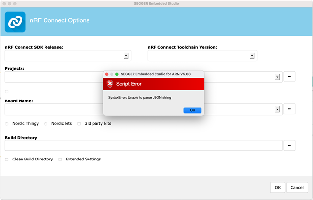

Suffice it to say that I've made multiple attempts to uninstall all of the related software, make sure I have cleared away any remnants, and reinstall nRF Connect, and SES (leaving VS code out of the discussion for the moment) all of this running on the absolutely latest macOS Monterey 12.3.  I have failed in this endeavor several times.  Multiple pieces of "trash" (prior state) seem to remain.  For example, when a freshly installed SES is started by clicking on the Open SES, the SES app opens, showing a dashboard which shows a list of recent project (not a blank list).  Then either upon executing the File | Open nRF Connect Project... command, or automatically without any user interaction, the new nRF Project dialog pops up with a covering error message:
Closing the error message leaves an unresponsive options pane.
So, clearly there's some remembered state from prior installs that's preventing a new installation from being done cleanly.  Searching for uninstall instructions for nRF Connect SDK yielded no useful information.  Even searching for uninstallation instructions for SES yields only one suggestion, which proved to be insufficient and didn't erase prior project history. Therefore, I request:

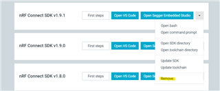

    How did you install the nRF Connect SDK? Manually or Automatically? If you have used the Toolchain Manager you should be able to remove the SDK using the dropdown menu
    It should also be sufficient to delete the folder where you installed the environment.

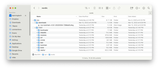

    I have automatically installed, removed and repeated this sequence several times with SDK v1.9.1.  The resulting Toolchain Manager window below shows that the final configuration Is broken in at least one way -- the Open SES button is missing.
    Here's the directory structure for the installed SDK.  Appears correct at this level of detail:

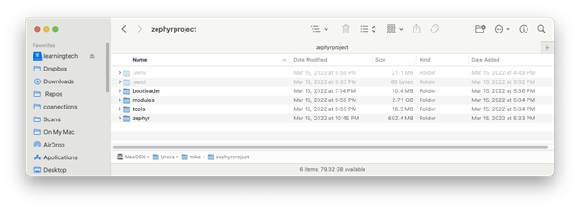

    I don't believe I've done a recent manual installation of the SDK.  I did however do a separate manual installation of the Zephyr system in order to create a testbed for working out some of my device tree and Kconfig issues without nRF SDK complications.  That installation seems to work OK, and have the recommended directory structure.

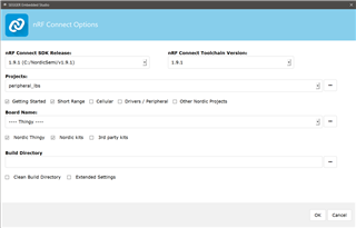

    Not in my experience After removing and reinstalling the SDK, old project info still persists in SES.
    First of all, this is a known issue with SES. But what version of SES are you opening, the one that follows Toolchain Manager or a manually installed? I'm not sure what you mean with list of recent projects. The Open nRF Connect Project dialog will list available projects in the nRF Connect SDK folder. This will be samples found under both nrf/samples and zephyr/samples, and you can narrow these down with the different checkboxes.
    Are you able to see nRF Connect SDK Release and Toolchain versions? Make sure that the Segger Embedded Studio actually points to correct nRF Connect SDK folder. You can check this under Tools --> Options --> nRF Connect --> Directories.
    There are 3 installations. Make sure to use the correct one in e.g. VS Code and SES, i.e. /opt/nordic/ncs/v1.9.1/

    Yes, indeed.  When I start up SES, its Desktop appears (by double clicking the app icon at: /opt/nordic/ncs/v1.9.1/toolchain/segger_embedded_studio/SEGGER Embedded Studio for ARM 5.68.app, the desktop opens.  If I then execute the File | Open nRFConnect SDK Project... command, the nRF Connect Options window opens with the Script Error dialog in the middle:
    If, however, I start SES by clicking on the alias at /opt/nordic/ncs/v1.9.1/toolchain/segger_embedded_studio/SEGGER Embedded Studio.app, SES immediately follows the desktop with opening the nRF Connect Options window with the same error message, without having to execute the File menu command.

    The answer to one question would allow me to do some debugging: What's the pathname of the script file which causes the red error dialog in SES: Script Error?
    Mike
