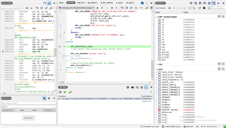

I have a datalogger application that samples data every second. It uses the following modules:
TWIM0 -> To communicate with external RTC clock via I2C.
TWIM1 -> To send data to external display via I2C.
SPIM2 -> To get data from an external ADC with sensor.
QSPI -> To save data to an external memory.
I use BLE central to scan and connect to another custom peripheral device using long range PHY. I send all the data every 10 mins to this device which works as a router.
Everything works correctly most of the time. The application continues to sample when the data is being sent simultaneously.
Issue:
I get a SOFTDEVICE: ASSERTION FAILED that happens inconsistently about 5 to 10 times a day when the BLE central is sending the data. You can see the call stack and PC in the attached picture.
I am using nRF SDK v16.0.0 with s140_nrf52_7.0.1_softdevice. Could you please help me with this issue?
    You write th t you get a SOFTDEVICE: ASSERTION FAILED but I do not see the relevant address for that. Can you double check to verify that you actually see a SoftDevice assert and get the PC from then? (There is no SoftDevice assert for S140 7.0.1 at 0x00000A60).
  • Hi Einar,
    Thanks for getting back to me. I usually see SOFTDEVICE: ASSERTION FAILED after I click on continue running the code. Although, this time I got this error as shown in the attached picture.
    I will try and recreate this issue today and get back to you with a screenshot of the SOFTDEVICE: ASSERTION FAILED.
    Any idea as to why the softdevice paused the code based on the previous screenshot? I'm guessing the issue was caused at 0x00020D48.
