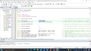

  • Hi Karl thankyou for the reply, im using keil for building and loading the code into the nrf52840 dkboard, after loading the ble_app_uart code into the dk board as per my understanding the bluetooth device name as per the code is "Nordic_UART"  as below.
    my question is this name does not get advertised when i open my bluetooth in my mobile, and also the iam not recieving any "Uart started" in my terminal as per the main code below when ever i restart the dk board.
    How have you verified whether or not the board is actually advertising? Does LED1 blink slowly? This is the usual advertising indication used in the SDK examples.

  • How have you verified whether or not the board is actually advertising? Does LED1 blink slowly? This is the usual advertising indication used in the SDK examples.
    The led is not blinking slowly it actually is continuously on and off for 100 ms.

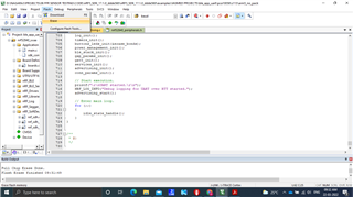

    How do you perform the programming of the device?

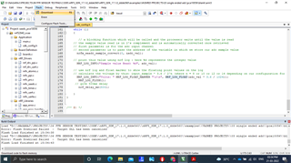

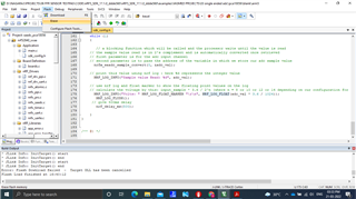

    i load the program using keil ide first i used to erase the chip as below..
    and i used to flash the program as below..
    From your logs it seems like your flash downloads are failing, are you certain that the programming succeeds as expected?
    Are you getting any logs at all, or is the device behaving anything like you would have expected?
    I think you should try to run an unmodified example first, to make sure that your setup is correct, before you try to run your modified example.
    Furthermore, it seems that your path to your project is very long. This could cause issues on a Windows based machine because windows has a path limit of 266 characters. I would recommend that you reduce your projects path length and also make sure not to use blank spaces in the path to your project.

  • From your logs it seems like your flash downloads are failing, are you certain that the programming succeeds as expected?
    The image i shared you is just to show you how do I erase and load a program in the nrf52840 dk board. The below is the log which i get for erasing and loading the program.

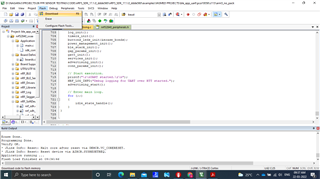

    yes when i load a uart program it works fine but for ble app it is not advertising any bluetooth.

    The example which i load is not modified it is exactly the same example in the sdk i just copied and pasted into my folder.
    Then it is quite strange that you are not seeing it function as expected.
    Could you try to run this in a debug session to see if the program unexpectedly is getting stuck anywhere?
    Could you also open an RTT terminal, like the Segger RTT Viewer to see if there are any unexpected logs being written there?
    The 'UART example started' message should appear in a regular Serial terminal, but all error loggings etc. will require an RTT terminal to view.
