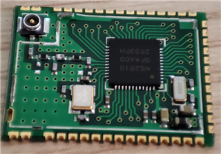

    The beacon board is based on a chinese module E73-2G4M04S1AX of Ebyte
    Below you can see its internal schematic.
    The version we have makes use of an nRF52810 with an external BLE antenna attached to it. We also added an extra 10uF capacitance.
    I also use the integrated DC/DC after following the reference circuit.
    First, do you think that this capacitance is enough?
    Second, What do you think would cause that damage to the module? I mentioned again that it was found dead after a week.

  • Thank you for sharing the schematics.
    It appears as if you might have doubled the capacitance on DEC1. The reference design for nRF52810 recommends a 100nF capacitor on DEC1. However, both the internal schematics of E73-2G4M04S1A that you posted previously(C18), and your own schematics(C7) shows a 100nF capacitor on DEC1. Using the right capacitance on the DEC pins is highly important. I do not know how doubling the capacitance of DEC1 will effect the circuit, however, at this stage I can not rule out this being the cause of your problem.

  • Hi again,
    I also noticed that the schematics that you provided for the module has a 100nF capacitor connected to DEC3. The recommended value according to the reference design is 100pF. As far as I know, this could potentially also cause problems. Could you please somehow try to verify that the schematic you provided for the module is showing exactly what is inside the module?
  • Thank you for your help!
    I did not notice those extra capacitors. I added them because I wasn't sure about the internal schematic.
    I also took a picture of the module
    Can you please provide more information regarding the importance of the pins you mentioned?
