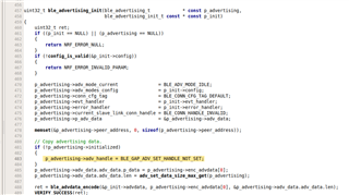

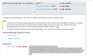

    I guess the problem is that m_adv_handle is set to BLE_GAP_ADV_SET_HANDLE_NOT_SET when you call sd_ble_gap_adv_set_configure(). The Softdevice does not support multiple advertisement sets, which means you have to re-use the same advertising handle for both your connectable and non-connectable advertisements.  Try to set m_adv_handle to '0' instead.
    Vidar
  • Thanks Vidar Berg! It works by changing m_adv_handle to 0.
    By the way, in the initialization of connectable advertising mode, I didn't see the value of adv_handle being set (See ble_advertising_init() in ble_advertising.c). Is the value by default equals to 0?
    While you mentioned the same advertising handle for both your connectable and non-connectable advertisements, could you explain it a bit so that I could understand a bit more about the situation I was in please?
  • The initial value adv_handle value is always set to BLE_GAP_ADV_SET_HANDLE_NOT_SET. Here from ble_advertising_init():
    It then gets set to '0' when the advertisement set has been configured through the sd_ble_gap_adv_set_configure() function (notice that p_adv_handle is an in,out argument):
