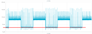

BUT, when I try to modify the application to force the processor into low power mode during the 1 second 'k_sleep', it doesn't seem to change from 3mA baseline at all.  I understand the spikes are the advertisements or connection keep alive, and turning on the LED also consumes another 5mA of current.  I'm going to disable the LED soon.  The USB is not connected to the DK board, only the black and red power leads from the PPK.

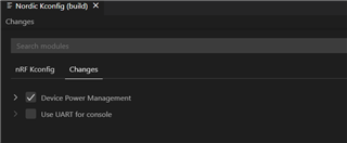

The power management was already enabled in the Kconfig, so I enabled device power management and disabled the UART for console (UART_CONSOLE).  This did not yield any better results.

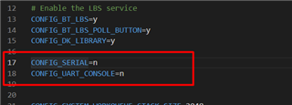

    The software running should be low power by default, so it should be enough to use k_sleep() forcing the CPU to idle mode. There can be active peripherals however, like the UART, as you mention, but I think you have to use CONFIG_SERIAL=n to actually turn off the UART as well, not just the console.

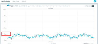

    Thanks so much!  I'm seeing below 2 microamps now during sleep.  If you think I can get it lower, please advise.
    I added these lines in the prj.conf file.  There were some warnings during the cmake config of Zephyr because the UART/serial was not available, but it still was able to build.
