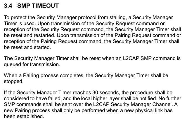

From the Bluetooth Core:
From Nordic Info Center:
#define 	PM_CONN_SEC_ERROR_SMP_TIMEOUT   (PM_CONN_SEC_ERROR_BASE + 0x101)
/* Pairing/bonding could not start because an SMP time-out has already happened on this link.
* This means that no more pairing or bonding can happen on this link.
* To be able to pair or bond, the link must be disconnected and then reconnected.
* See Bluetooth Core Specification 4.2 section 3.H.3.4 (Bluetooth Core Specification).

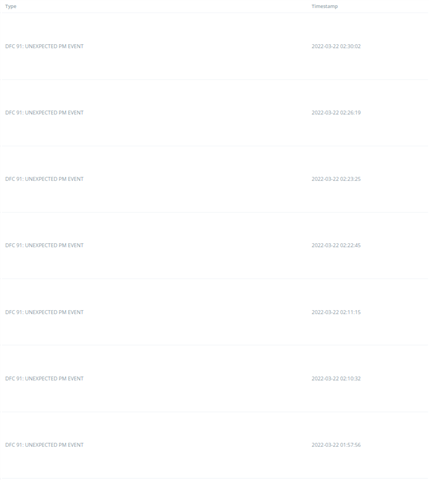

    when one device starts getting 4352 it keeps showing. The following table is a log from a single device and the UNEXPECTED PM EVENT is always 4352. Here you can see it pop out every few minutes.
    While this happens a lot on the field, the conditions are not very well understood and, likewise, its hard to get a setup where this is consistently occurring and we can test different approaches.

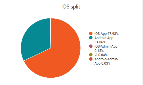

  • Still generating data for this analysis. If I do an OS split our community shows this distribution:

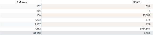

    In the following table you can see the PM error distribution also split:
    There is a huge difference, specifically for 4352, showing up much more often in iOS that in Android.
    It is still difficult to understand what causes this error when it is not possible to reproduce it regularly. I don't know what sort of devices this is. The error should occur after a disconnect, so it would still be useful to know the disconnect reason. If the devices are simply loosing radio contact (out of range, turned off) it would have a natural explanation. May that be the cause? A sniffer trace could be even better, (nRF Sniffer for Bluetooth Low Energy), as it could show some details if either of the devices are breaking the specification.
