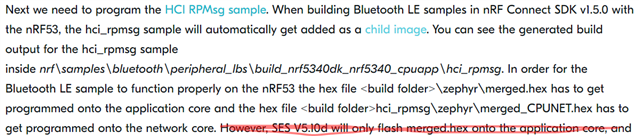

in the last chapter of
its explained to program on different cores of the nRF5340 (network or application). I am using the VS Code nRF extension and lashing the example "peripheral_lbs" is working = my nRF5340DK LED 1 is blinking and on my iphone app nRF Connect Nordic_LBS is visible with the service Nordic LED and Button Service.
Next explanation in sdk-tutorial part 1 (link above)

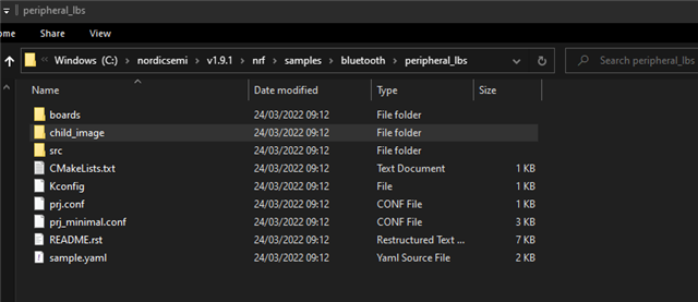

Both files
1.
C:\nordicsemi\myapps\peripheral_lbs\build\zephyr\merged.hex
2.
C:\nordicsemi\myapps\peripheral_lbs\build\hci_rpmsg\zephyr\merged_CPUNET.hex
can be found in my project directory, but I dont know how to program the .hex files to different cores??

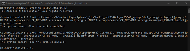

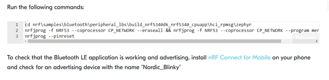

The "Open command promt" way gets the error

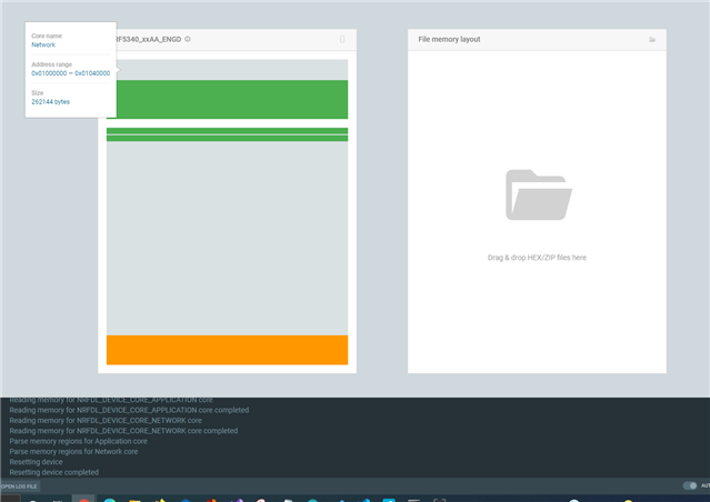

So at the end I cant find the "Nordic_Blinky" advertising device through my mobile phone.
Is the network core empty in the screenshot?
