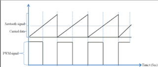

  • If I understand your question correctly, then it is correct that the duty cycle (given in ms) is not dependent on the period.
    I only found a poor image, but let me try to explain:
    The PWM in this case is the TIMER counting from 0 up to TIMER_RELOAD (32000 from your first post).
    When the timer reaches the value in NRF_TIMER3->CC[PWM0_TIMER_CC_NUM], the PWM pin will turn on, and when the timer reaches the TIMER_RELOAD register, the PWM pin will flip back, and the timer will reset.
    NRF_TIMER3->CC[PWM0_TIMER_CC_NUM] = value;
    (this register value is set in your pwm0_set_duty_cycle())
    So if you change the value of the CC[PWM0_TIMER_CC_NUM] register, it will change how far the counter needs to count before the signal is turned on. the value in NRF_TIMER3->CC[TIMER_RELOAD] decides how far the timer will count before it resets to 0. So you can change one of them without affecting the other***
    *** As long as the value in the TIMER_RELOAD register is larger than the PWM0_TIMER_CC_NUM register, or else the PWM pin will never flip.
    *** The duty cycle in ms doesn't change, but the duty cycle as a percentage of the PWM period changes when you change the period. However, if you are using the servo motor that I suspect you are using, the duty cycle is read out in ms, and not percentage of the period.
    That being said, I am not sure how this servo motor will behave when you change the PWM period (TIMER_RELOAD). If the datasheet expects 50Hz, I am not sure how it reacts on a frequency of 60Hz. I suspect that it doesn't improve the behavior of the servo.
    Edvin
