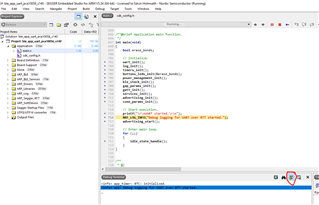

I am playing around with the nrf52dk for the last 14days, done some progress, namely the TWI is working and I can read the sensor and printing its values in the debugger inside, when the emStudio is working, without a problem, I have even started to use the RTT, indeed, JScope works all good...
The major problem I am having is with the " Debug terminal " within the emStudio. The JLink has to be reset all most every time after the programm has been flashed... how to make this stable? I am using basic nrf_log...  In addition, if you develop the RTT , do you even bother with this terminal? Or should I rather switch to the UART, putty and alike, what is the strategy usually with regard to the debugging processes ? However, I am not sure , can both be used at the same time :)

    My understanding is that you want to monitor the log, and you have tried to monitor the RTT log using an "external" tool, like RTT Viewer while you are debugging in Segger Embedded Studio (SES), is that correct?
    As you may have noticed, we have two log backends. RTT and UART. Because of what you describe, I actually prefer to use the UART unless I need the UART for something else in the application, or if I need to log a lot very fast. In those cases, the RTT log is superior.
    However, when you reset or reprogram the nRF chip, you'll need to reconnect the RTT viewer, which is kind of annoying. But if you are using SES, then you can actually use the debug view to monitor the log:
    However, for some reason all of our SDK examples (I am assuming you are using the nRF5 SDK) have a configuration in sdk_config.h that some versions of Segger Embedded Studio doesn't like. If you have enabled the log in sdk_config.h, and use the RTT backend:
    #define NRF_LOG_ENABLED 1
    #define NRF_LOG_BACKEND_RTT_ENABLED 1
    And you don't see any log when you start a debug session, please look for this config in sdk_config.h, and set it to 0:
    #define NRF_FPRINTF_FLAG_AUTOMATIC_CR_ON_LF_ENABLED 1
    // Change it to:
    #define NRF_FPRINTF_FLAG_AUTOMATIC_CR_ON_LF_ENABLED 0
    And you should see the log in your debug view in SES.
    That being said, if you set a breakpoint after the softdevice (Bluetooth Low Energy stack) has started, you need to reset the application in order to continue, because the softdevice will miss several timing critical operations, and it will crash if you just continue after a breakpoint.
