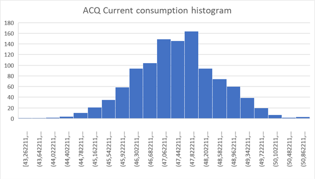

SAADC peripheral gives me good results in acquiring & converting a DC signal related to current consumption.
I am using the 12-bits configuration over the internal reference with 1/5 gain (input signal ranging from 0 to 3v). We perform sampling at 1Khz thanks to the blocking procedure named nrf_drv_saadc_sample_convert at a 10us sampling time
At this stage, if softdevice is off, we got a normal measurement and plotting histogram of the several measures shows a normal distribution according to the noise error gaussian form.
Sounds good!

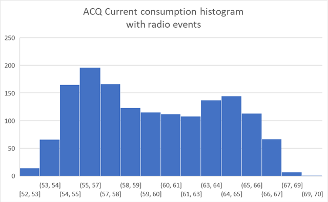

However, just by starting softdevice (+8dbm level selected), things are starting to go wrong since extra noise is added to the initial signal resulting in the following histogram (do not look at absolute values which change from the previous picture):
As we see, a second noise pattern is visible on the right part giving me wrong results when averaging acquired samples.
I am using softdevice 7.0.1 and I was asking myself what kind of trick could I use to overcome this chip noise issue?
Is it chip noise issue due to radio event?

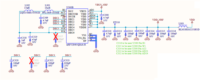

    Do you have the DCDC regulator enabled in your application?
    No, I don't see any softdevice action to activate the DCDC regulator in our code. We use external LDO
    Here is also for information the Nordic schematic for the supply part:
    You can consider enabling oversampling in the SAADC to reduce noise, but this will take more time, and should have given similar results to what you get if averaging manually.

    Thanks for posting the raw samples. It looks like you have a difference of 14 symbols between min and max sampled value, which corresponds to ~0.34% with 12 bit resolution. I think this is well within the specifications of the SAADC peripheral (there is a gain error of +/-3%, calibrated offset error of +/- 8 LSB12b, etc).
    Are you running any (periodic) offset calibration in your application?
    Have you checked if the "offset" samples corresponds with radio activity, etc? You can use the radio notification feature or the PA & LNA GPIO toggle feature to see when the radio is active. If you use this to toggle GPIOs on radio activity and do the same when the SAADC SAMPLE task is triggered, you can see the GPIO toggling using a logic analyzer, to see if the sampling overlaps with the radio activity.
    Radio activity, flash activity, and high current consumption may cause more noise on the SAADC sampling.
