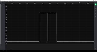

I am having trouble powering my uicc. I feel like I am just looking for some setting, but I have not found the right one yet and I am at a loss at this point.
What I have done is the following. I have flashed modem firmware to my nrf9160 ic (v1.3.1). I have taken an example application (cloud client) and an existing board configuration (thingy91_nrf9160) based on the SDK v1.9.0. I then edited the board configuration to our own custom board, basically removing everything from it but the bare necessary (gpio debug pin, i2c interface and the necessary flash configuration which I just left as is from the existing configuration). I added some RTT logging to my configuration and built and flashed the thing, expecting to at least get some information transfer going between the modem and uicc.

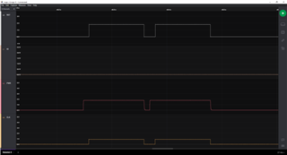

However, the modem seems to keep going into some sleep mode and is not powering my uicc. It turns on for a couple hundred ms and then turns off again. Then 30 seconds of nothingness, and the modem tries again. See the included capture of the uicc 1v8 line.

The same happens with two SIM cards, both seen working in a Thingy91. Measuring 1V8 to the card on the Thingy91 board also revealed that the voltage there is a continuous 1V8.
At this point I have gone through the Kconfig a couple of times scanning for any sleep or power management configurations, but with no luck so far.
Can anyone point me in the direction of some sleep/powermanagement setting/documentation which might cause behaviour like this.
