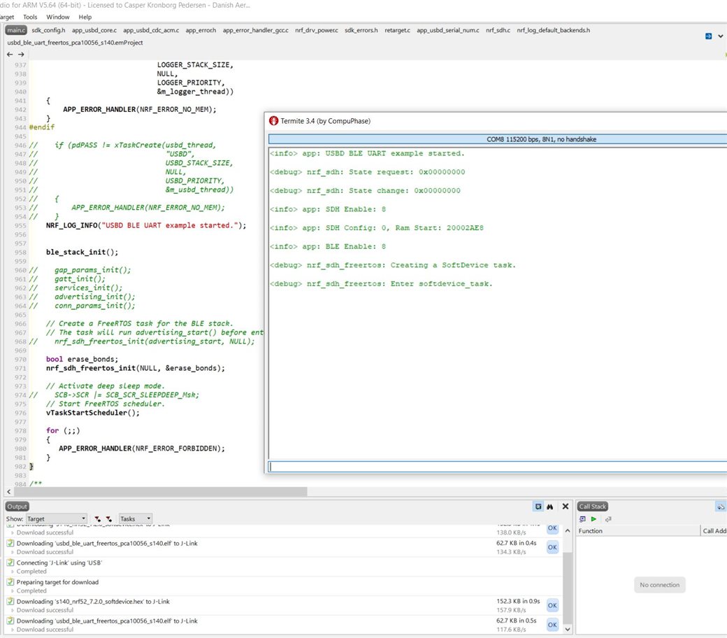

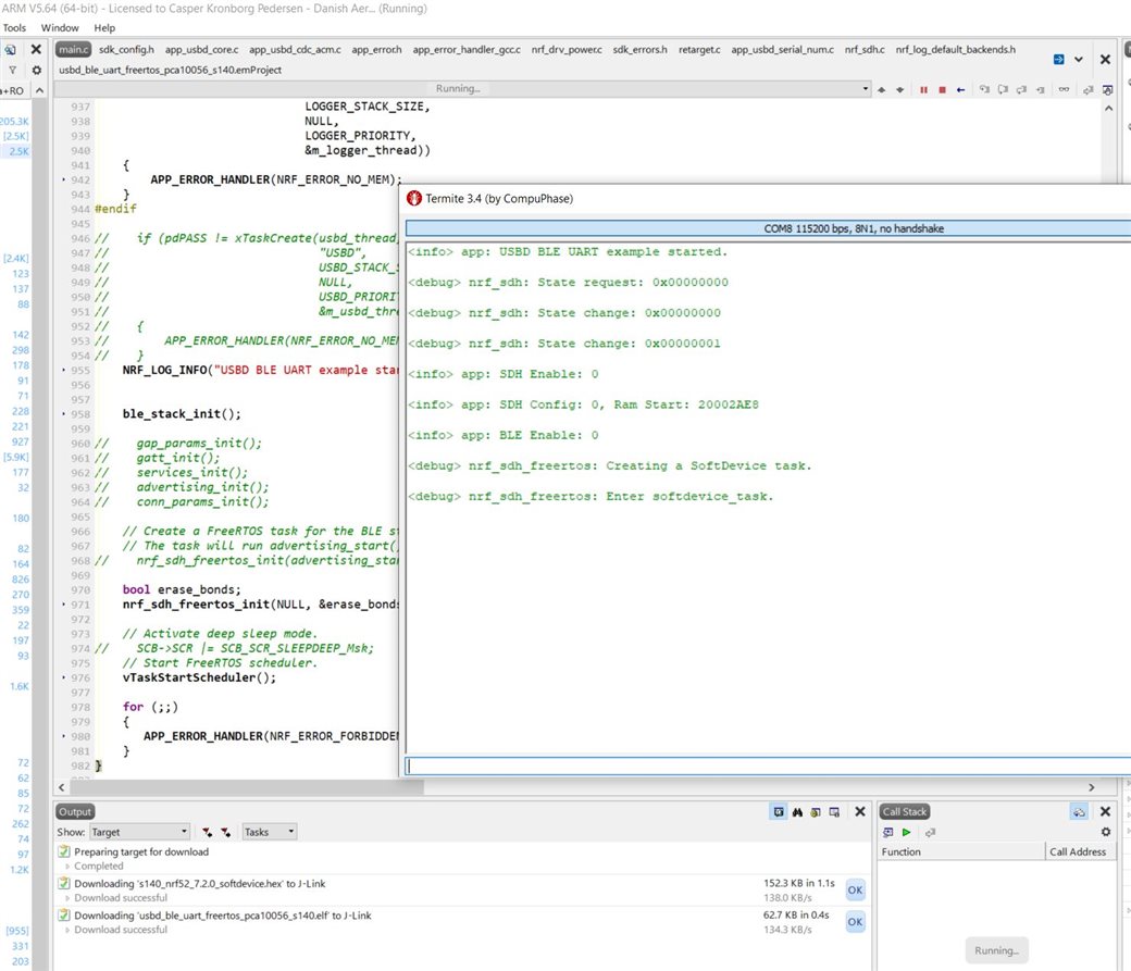

  • Hi Edvin,
    Edvin said:
    FYI, Segger will flash the softdevice for you, as long as it is specified in project settings -> Loader -> Additional_load_file[0].
    I was aware that SES was flashing the SoftDevice since the Output log tells me so, but thank you for telling me :) I only used the nRF Connect For Desktop to avoid using SES for flashing as a test.
    I just want to quickly show what I am getting when using "Build and Debug":
    "Build and Run":
    I am using a fresh SDK and the file I sent you. I am just quickly posting this to clarify before I recheck the exact point of failure so you can see the behavior I am experiencing.
    Br. Casper
    EDIT: Additional information. I am using REV 2.0.0, 2020.2 of the nRF52840-DK.
