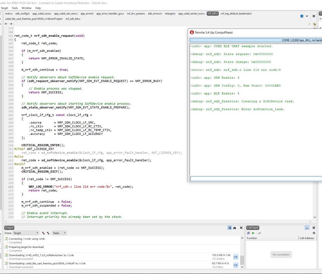

  • Edvin said:
    Is the issue still that sd_ble_cfg_set() returns NRF_ERROR_INVALID_STATE?

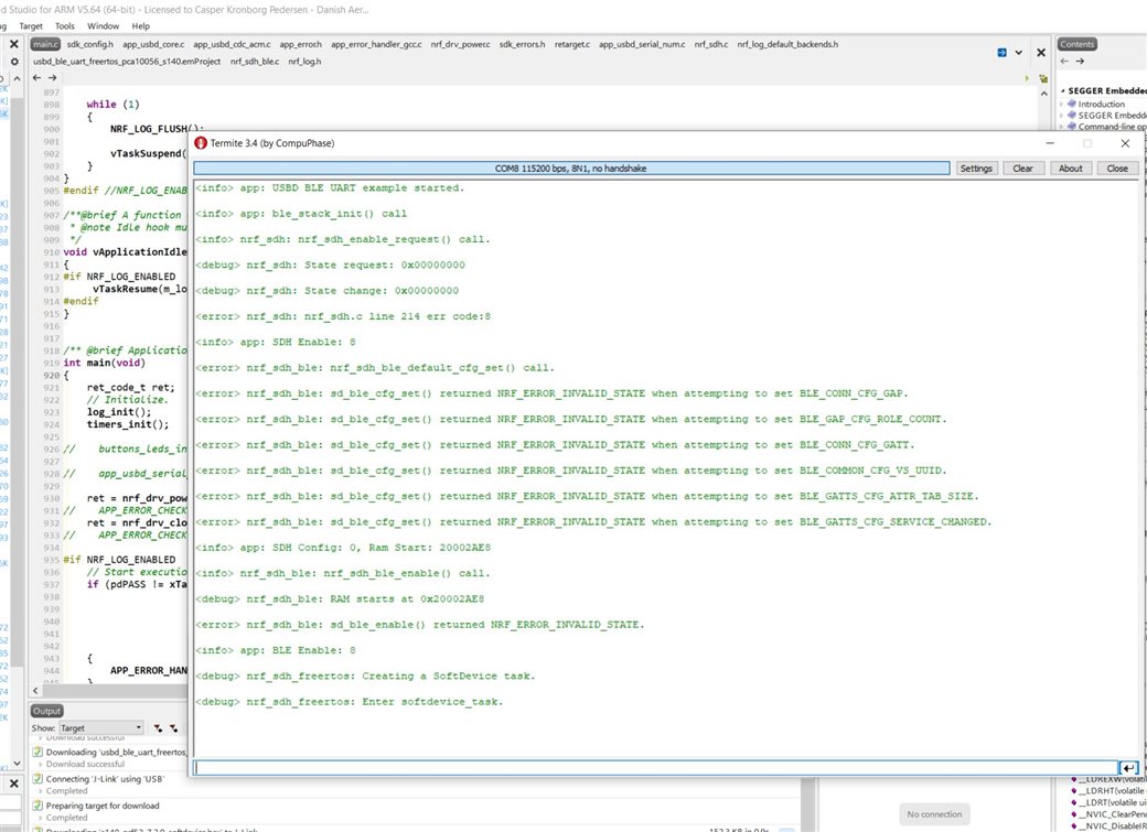

    No, it is nrf_sdh_enable_request(), specifically in the nrf_sdh.c file in line 214. Here is a screenshot of an additional log line I just added:

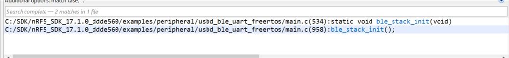

    Edvin said:
    Are you sure you don't call ble_stack_init() twice in your project? Or that you call nrf_sdh_ble_default_cfg_set() from several places?
    Edvin said:
    Check from your log by adding some logging inside that call to see whether it is called one or two times.
    I just checked the project to see the amount of times each function is found.
    I will add in the log output reply below where I have added the extra log messages inside those function calls.

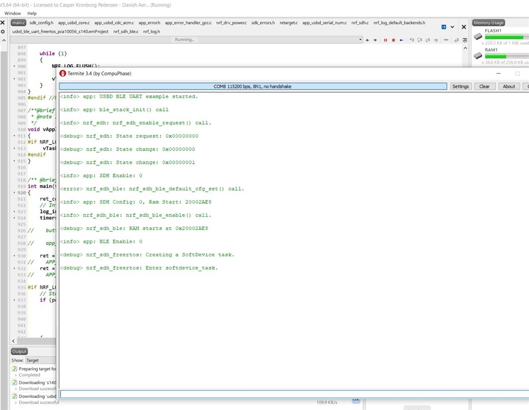

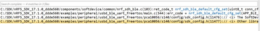

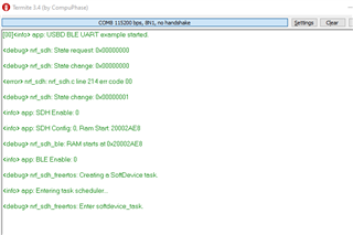

  • To get the nrf_sdh_ble_default_cfg_set() function to output any NRF Logs from within I had to enable NRF_SDH_BLE_LOG_ENABLED in sdk_config.h. I also set the Log Level to 4 to get all outputs. As you will see, this provided additional information.
    "Build and Debug" - With Extra  NRF LOGS:
    "Build and Run" - With Extra NRF LOGS:
    Sorry for the many large images and me continuously posting, but I hope this helps clearing things up.
    Br. Casper

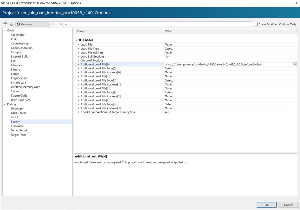

  • About the additional load file, I did check that as well:
    Br. Casper

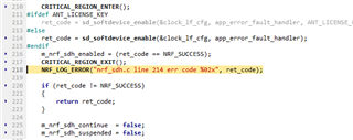

    I added the line "nrf_sdh.c line 214, err code %02x", err code" outside the if, since it didn't trigger otherwise:
    from your log it seems that it returns 08 from the initial run, unless the line "app: USBD BLE UART example started is not the first thing that is printed when you run your application (If there are more logs above that).

    Something that might be causing the problem: We then tried rolling back SES all the way to 4.16. This makes the files I sent you work, as well as our two projects that are being ported. Hoorah!
    As soon as we upgrade SES back to 5.64 or 6.20a, the error reappears... Even after fresh unzips of files and SES installs. This has been reproduced on two separate computers.
    However, sticking with a very old version of SES could be painful and does not seem like the solution..
