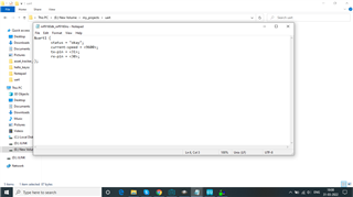

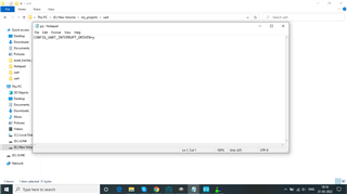

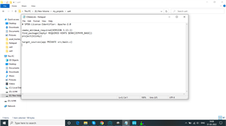

    please help me , what to to read data
    Still missing some information in order to help. What kind of sample are you working on? On what board are you trying to read UART, is it the nRF9160DK or a Thingy:91, or is this a custom board?
    What does the output log show, can you please provide the log for me to see?
    Øyvind
  • You are right. My apologies, I was answering too quick and did not do my job of reading the provided information.
    It would be great if you could share the files as files, not screenshots. You can use the Insert --> Image/Video/File to upload files, or you can drag and drop files to the "text field" to attach files.
    That said, what sample are you working on? You write that you found another sample, but from where? What version of nRF Connect SDK (NCS) is this written for? I see that the overlay file is named nrf9160dk_nrf9160ns, however, in the latest version of NCS (tag v1.9.1) it should be nrf9160dk_nrf9160_ns.
    That said, have you verified that the pins in the overlay are available? See our nRF9160 DK Hardware user guide

  • i am connecting ADC card which read analog signal from load cell and covet into digital signal and send it on Tx terminal of ADC card .
    i am using p0.10 pin Rx pin of nfr9160 to read data (i also tried whole pin of nrf9160 to read data)
