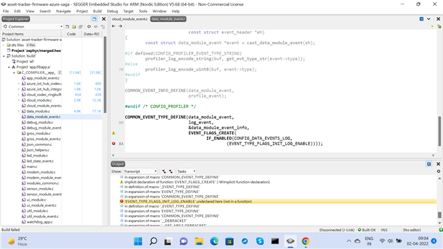

Hi, I downloaded a project from Git. I tried to open in SES using nRF Connect SDK. During the initial Cmake, the error occurs as shown in attached image.

Could you give me a link to the project you downloaded? There seems to be some issues in the Kconfig files.
Hi, after making changes in Extra Settings, as suggested by you, the project got created. When, Build is RUN, the following error occurs
Do not add the conf file from another project.
You should go through the Getting Started section of the documentation that I linked, there you will set up Azure and get the value to should set CONFIG_AZURE_IOT_HUB_DPS_ID_SCOPE to.

Where is the azure-tracker-cloud-firmware-azure.conf file in asset_tracker_v2 ..?
There are multiple versions of the application, and the version in 1.9.1 does not have that config file. So you can remove that file from the CMake Build Options when you are building the version found in 1.9.1.
Be sure to set the mandatory configs in overlay-azure.conf, as described in the sample's documentation: https://developer.nordicsemi.com/nRF_Connect_SDK/doc/1.9.1/nrf/applications/asset_tracker_v2/doc/cloud_module.html#mandatory-configurations

mexco said:1. How to remove/ exclude the commands issued using Extra Settings while opening/ creating a project ?
If you look at what you are writing in Extra CMake Build Options, you will see that the part after the '=' character is a list of config files separated by semicolons, if you remove azure-tracker-cloud-firmware-azure.conf, you are left with:
-DOVERLAY_CONFIG=overlay-azure.conf;overlay-debug.conf
These files are merged with prj.conf to create the full list of configs.

Yes, you must edit overlay-azure.conf and add the correct values for your Azure Cloud in order to run the sample.
