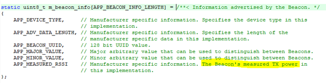

Then I found a comment that says that the APP_MEASURED_RSSI parameter is responsible for the TX power

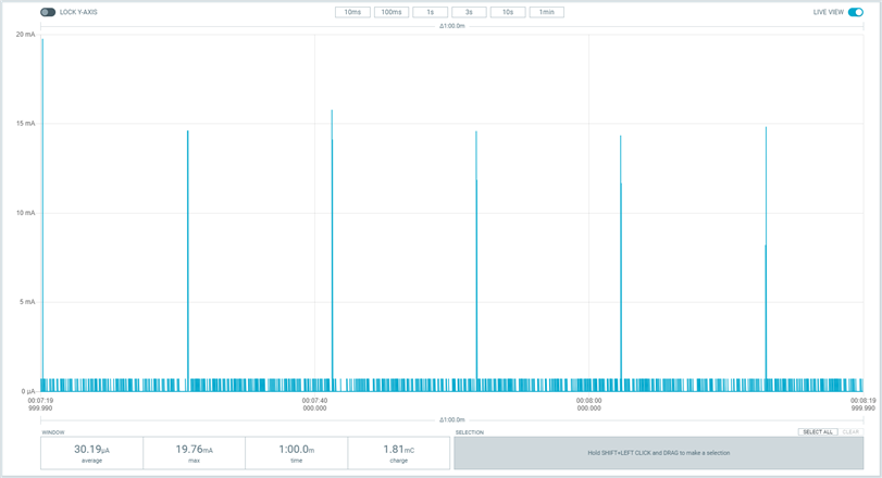

but its changes do not affect the power consumtion (look at the peaks) APP_MEASURED_RSSI =  (1)63 dBm (2) 0dMb (3) -61dBm):
(1)
(2)
(3)

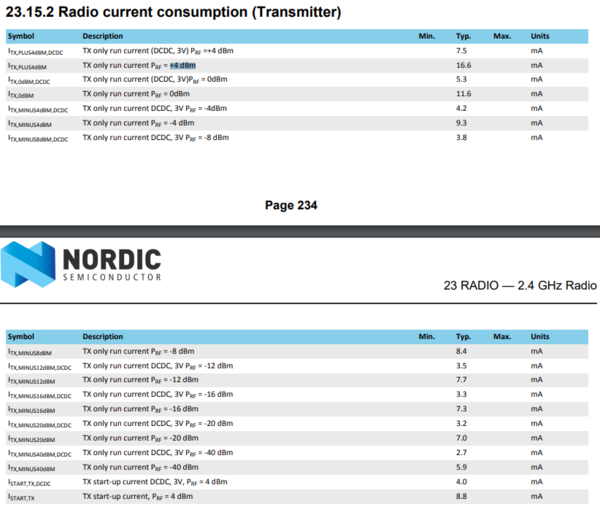

These peaks looks like TX power +4dBm (16.5mA), but -40dBm (5.9mA) would be enough for me. The table is below. Please, tell  me how can I change this TX power in my case?
    That is not correct. This is just a information about the typical RSSI measured at a fixed distance from the beacon to make it a bit simpler to estimate distance based on RSSI.

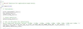

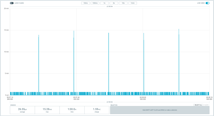

  • Thanks for the answer! I found an error. I called sd_ble_gap_tx_power_set() with the wrong parameters in the wrong place (facepalm)
    maybe it will be useful for someone, in the ble_app_beacone example (from SDK)  you need to write it here:
